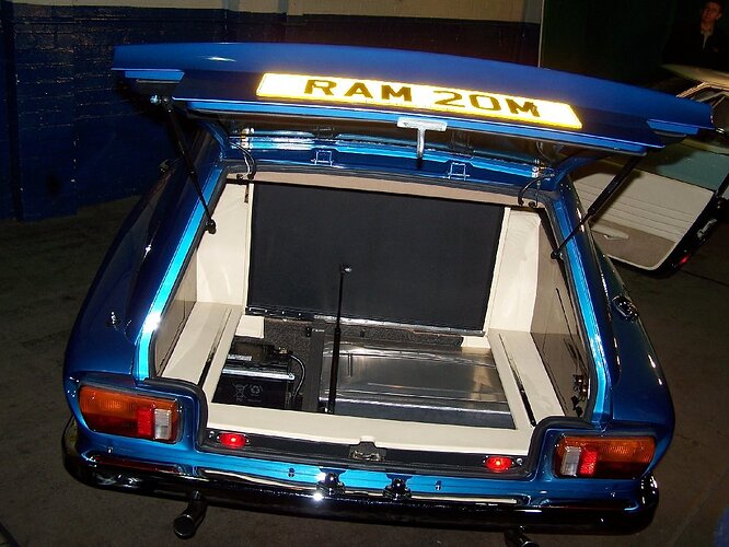

Apart from the bodywork, the big challenge would be the fuel tank. Any idea where you could put one?
Best regards, iain
possibly like the baby elan and in the boot floor???
well I suppose thats if youre making a ‘deck’…
there should be room in with the spare wheel just depends on what size it’d end up being…you may need to reduce the capacity a little…
I could try and sneek a picture next week as I have to go back to PMs to pick up the rebuilt water pump I left this weekend.
To me it looked as though the tank was below the boot floor as the boot floor was quite high…

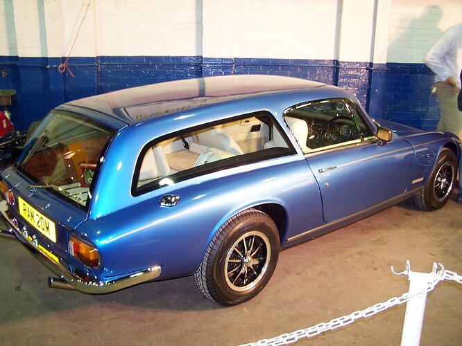

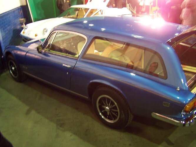

I may as well be the first to post piccies…
Given the fragile nature of Loti… and taking a cue from Clive, I suggest calling it a Sports Break.
I understand they managed to reduce overall wieght by 200kg (maybe Helium in the tyres)…
Jeremy
It actually looked just as bad as we all expected, although the workmanship was excellent.
Outside was the Elite (original, not the wedge) hatchback; this is in a different league and looked like it was designed like that from the word go.
Cheers,
Pete.
:smiley:

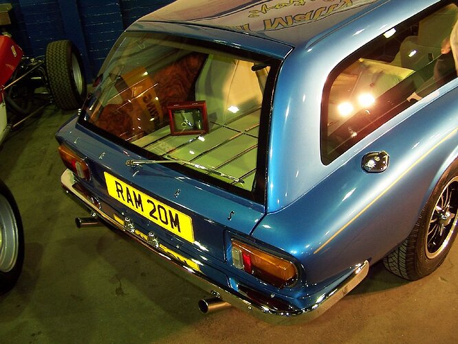

I don’t think the lines of the overall shape is too bad, but there is a big difference between good workmanship and good automotive design.
My main quibble is the fact that the new glass sections bear NO resemblance to the originals.
They have the thoroughly modern treatment of black inside edges and no outer chrome surround, which jars with the original side windows.
Also the top corner of the new rear side windows has no relationship with the angle of the existing side window top corners. I would have thought these two points to be fairly obvious design clues to follow when someone put this much money into what is an accomplished conversion.
THOR ! That was my concern as well when we were building the car.
But worse would have been the case …if we had gone down the route and found that we had problems with leaking windows.
Paul and I have spent countless hours discussing this and I took his correct advice and eliminated that problem. Not having unmimited funds We had to compromise on that.
I’m, sure someone would have complained had we put perspex instead of glass in the windows. I also wanted to keep the rear 3/4 vents so familiar to us on a plus two, but that proved difficult as well. But we kept the rear light clusters and indeed the car is still recognisable as that from the back including the lip on the boot lid.
As regards the shaping of the car windows, after discussions with Shapecraft who crafted the aluminium top by hand - Paul and I had to come to a decision that I could either shelve the project or accept their interpretation of the design we had given them. In the end it was my decision to accept the design of a company that works with shaping cars for far wealthier individuals than myself.
It may not be perfect but it is unique. My family and I like it, and to me that is what matters most! It will serve the purpose for which it was built and if you look at the shooting brake website you will perhaps find other designs you may not like much more.
Above all let’s ALL enjoy driving our loti. I would hate to have to drive some boring mundane family saloon !
I look forward to enjoying our new family car.
:smiley: Roger Makhlouf ,
(who commissioned Messrs Paul Matty Sportscars and Shapecraft with this project)
Ah, this is becoming interesting;
i didn’t pick up on the fact that you were the owner of this car, Roger.
Despite of the window treatment, I do like it, and find the inside boot area especially pleasing, and on par wth a DB4 shooting brake I remember from an article. If I can speak my mind, I find the quality of the work, and the pleasing line of the roof offsets my quibbles on the window treatment, though it might have been better with slightly narrower black edges on the inside of the glass. Certainly in another league than the Elanbulance. And the colour is good.
I would not like to guess at the costs…
