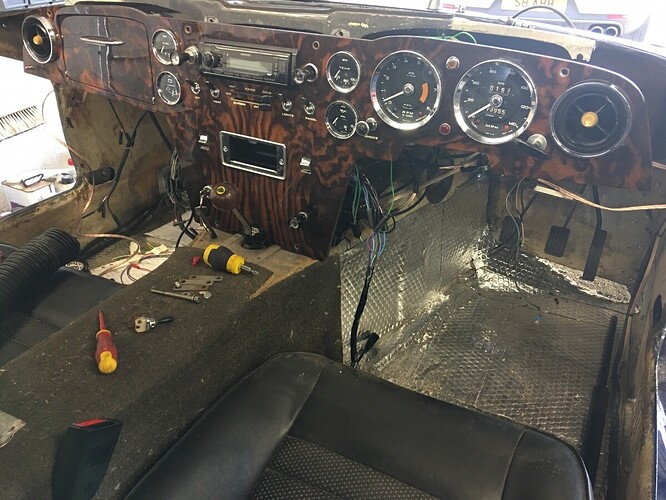

So last weekend I got the dashboard basically back in, with loose ends yet to be addressed. I’m finding now that the fit isn’t excellent, to be expected when I’ve had things that settled-in together for almost half a century apart and refurbished and re-assembled. The lower end doesn’t want to go all the way to the bracket and in fact cannot, at the very least because the Tang of the headlight vacuum-valve is about a milimeter from the heater, which itself is firmly mounted all the way in that it’s supposed to go. I’m also seeing tight clearances against the heater with the terminals on the bottom row of switches. As my center console is off far away right now I can’t check how big a problem this poor fit will be. What the picture doesn’t show is that the wood is basically right up touching the shift lever ball-cup.
Any thoughts? How much tolerance do I have with the placement of the lower end of the dashboard?

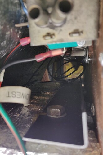

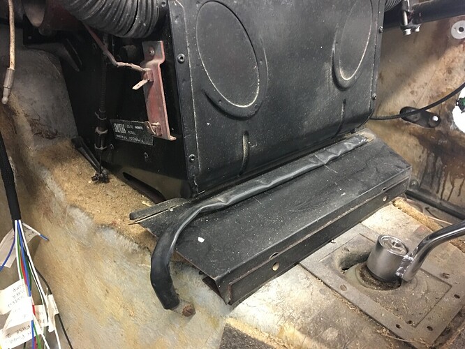

This is my early Plus 2 dash mounting and heater. Even if the dash won?t quite go tight to the bracket it would still be well clear of the gear lever by the look of it. I?m in the process of fitting my dash so will have a close look tomorrow, but I no longer have the vacuum switch as I have gone to electric motors for the headlight raising. I?ve been waiting for new ducting to the windscreen vents to arrive before I can finally push the dash right back. The tight bit looks like the bundle of wires in the harness in the centre of the dash, might need a bit of rearranging and clipping into place!

BBB, your lower mount is definitely different to mine; never seen that type before. Interesting.

Since posting this I’ve reviewed some pics from when I took it all apart and while I wish that I’d known this question would come up, from what I can make out in the pictures I might be OK. It looks in one of my pics like the dashboard may have been up against the shift-ball before everything came apart, and that would explain the holes in the lower bracket, which look like somebody hastily tried to elongate them. I can’t go by witness-marks on the bracket since I stripped and repainted it, but maybe this all adds up. I won’t know for sure until I get my centre console back, but it looks easy enough to deal with.
I think that the pictured generous clearance is in 4th gear, and with an Elan rather than +2 shifter
I think it is the square section of the +2 shifter that chews at the bottom of my dash in 1st and 3rd
Again not a plus 2 but my heater mates to a fiberglass plenum that is a separate piece although it looks like part of the body. Perhaps a compounding of misalignments? Sounds like others have the same problem. There is 7/8 in from the front of my console to the forward edge of the shifter hole.
Early +2. Dash not quite ready. OE dash has some evidence of damage at lower edge in the region described, I always thought due to maintenance work by previous owners.
My bracket looks like BBBs.

In case it helps I took a couple of measurements ( bear in mind I haven’t yet tried my assembled dash).
I put a vertical sheet of metal (2mm) against heater (narrow enough to not rest on the flanges that rivet it together).
I put a straight edge along the forward edge of the chassis bolt shafts.
Distance between these is 37.0mm
A further measure from metal plate to centre of gearstick mounting bolt (ie shift shaft and anti sizzle mount not fitted), when in neutral gives 116mm.
I hope this makes sense and helps to work out what’s going on.
