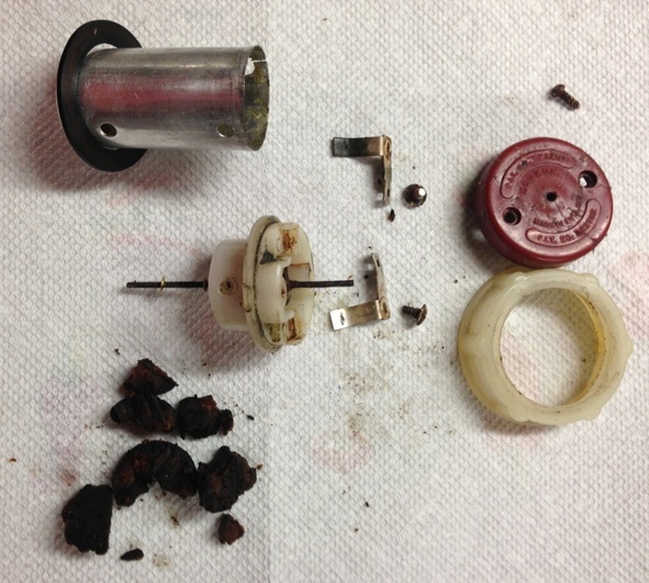

It is called a ‘Sovy Valve’ and it can easily be refurbished with a good wine cork. It all comes to pieces with a bit of patience. I did mine some years ago and it has been fine ever since. The hardest part is getting the rusted rivets out but with a bit of a soak in WD40 or similar they eventually come out.
Do a search for ‘Sovy Valve’.
Alan.
The thing is called a Sovey so you can search on our site on hiw to restore..
You can take it apart and rebuild: the cork , which rots after decades marinated in brake fluid can be replaced: I used an artifical cork from a cheap bottle of wine and found it is the right size and resistant to brake fluid.
The cork holds a steel rod which rusts: I replaced it with a brass rod of the same diameter: the rod has a brass “stop” disk which engages with the contacts: (or make one from a thin scrap copper sheet). You then have to thread the disk and the cork onto the rod and set float and disk the right heights so that when the resovoir is full, the cork floats, pushing the rod up, which allows the copper disc to clear the contacts and there’s enough of the rod poking out of the top of the red cover to show you the level is OK. Conversley, when the fluid level drops , so does the cork and the disk makes contact with the contacts so the dash warning light goes on, and less of the pin is visible out of the red cap . To set the disk on the rod at the right distance, I cut the crimp end off a lucar connector and crimped it on the rod: gently at first to allow it to be pushed up and down to get the distance right, then nipped tight and a spot of solder to hold. Suggest leave a generous amount of the rod sticking out from of the red top and trim back when you get the float and disk positions right. ..Good luck..

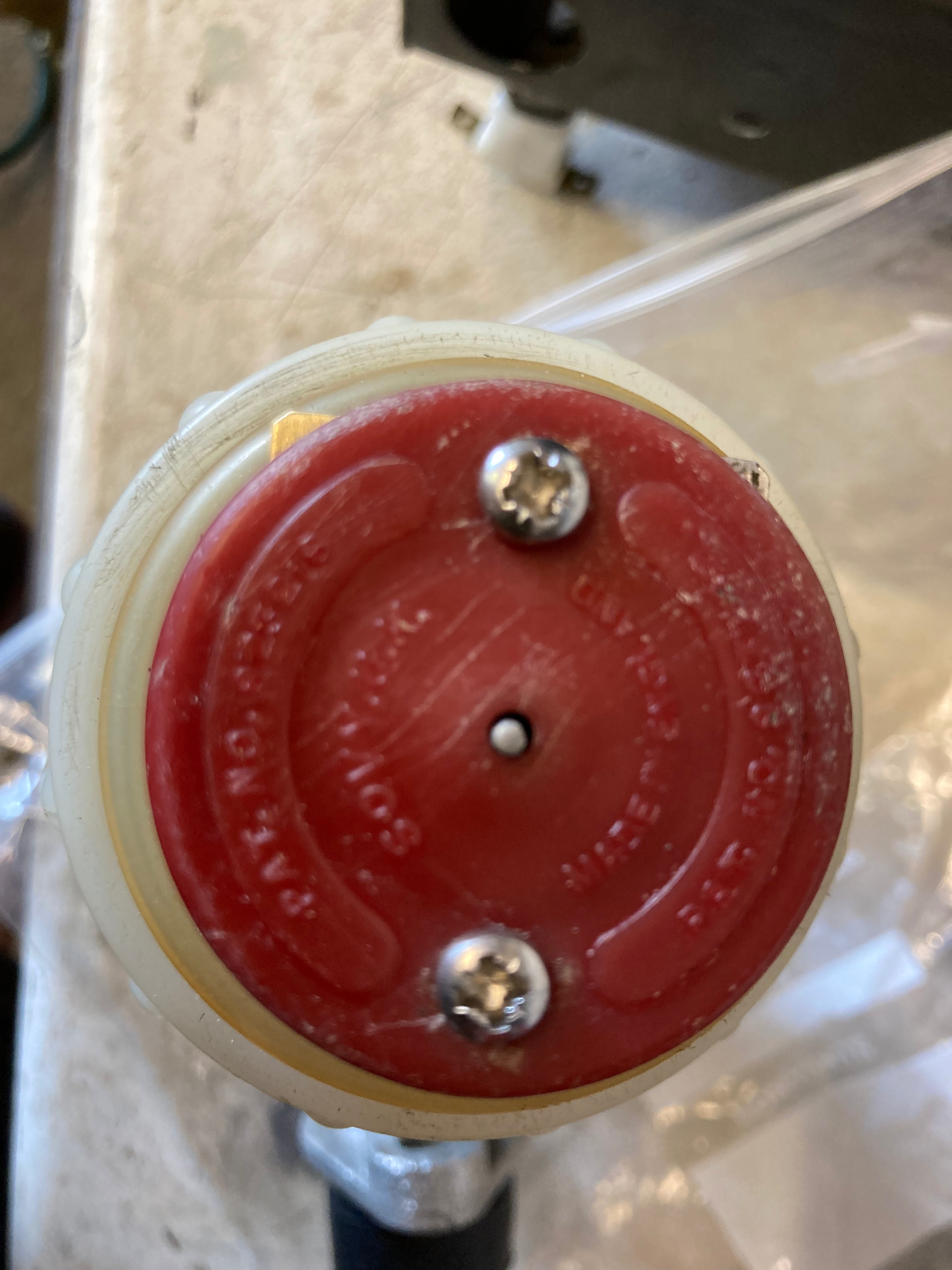

Hi Alan,
When you say rusted rivets, did you lever the red top off? Or did you drill the rivets out?
Carefully drill them out and replace with screws.
They are drive rivets, like a very course thread. No need to drill them out, you should be able to lever them out & re-use them. You can see them in this picture:
Jeff,
As above. I didn’t drill the rivets out in my Sovy valve. I just soaked in WD40 overnight and then gently teased them out. I re-used them on reassmbly.

I have taken all the great advice from you all who answered my questions and I stripped all the components of the sensor down. Whilst it is a crude device, it has lasted 54 years before that old cork became brake fluid logged.
A suitable wine bottle cork found, cut down to length, all parts cleaned, de-rusted and put back together. One minor modification, I did solder the brass washer to the spindle to make sure that the cork was secure.

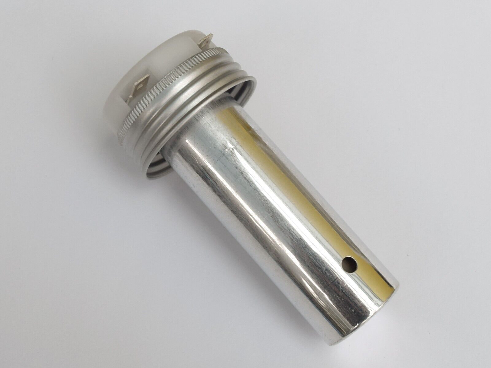

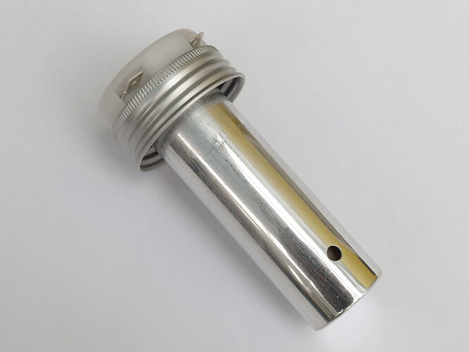

I replaced mine with one for an E-type, which I bought from ebay:
It’s listed on ebay under Classic Jaguar Brake Fluid Sender Unit Cap E-Type Mk10 420 Saloon Daimler C23631
I had to modify it a little to fit it - I think it was the cap that was the wrong diameter so I swapped it to my original cap - I’ll see if I can find some pics.
