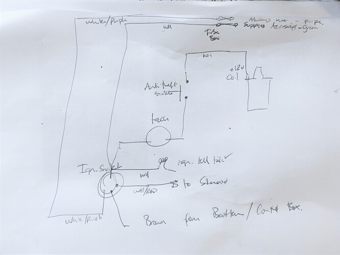

As built with the RVI set up, it looks like the ignition switch supplies power through the Tacho to the positive terminal of the coil:
So If I detach either white wire from the back of the tacho the car will not run, but if I connect them together the car runs fine.

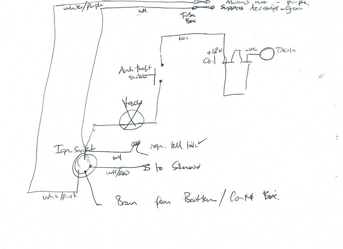

To remedy this, here is the original tacho wiring with the RVI Tacho between the ignition switch & anti-theft switch / coil +ve:
And the modified wiring with the Spiyda modified RVC Tacho connectted by a new wire to the coil -ve:
& for completeness I note that I had to add a 100 Ohm resistor on the input of the Tacho.
If I get a spare minute I’ll draw these 2 diagrams up in Visio or CAD, but you get the idea…
