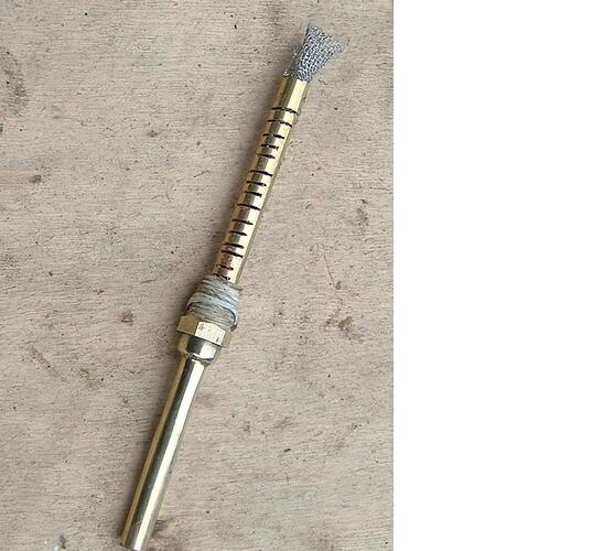

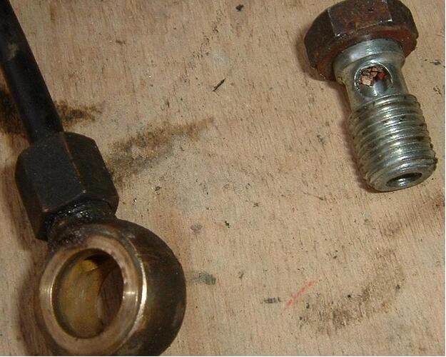

I changed the fitting, but for a different reason. The standard arrangement is a banjo bolt. The problem I found was this was partially blocked with tiny bits of stuff in tank, and caused fuel starvation. I used to clean this or blow back through the pipe to clear it. Never worked for long, though. The obvious solution would be remove, clean or replace the tank. But regular readers realise I’m too lazy for that. The new design is made out of a gas fire connection from B&Q. Amazingly it has the right thread (1/4 BSP, I think), and the right pipe bore 5/16. This arrangement does not have any constrictions inside to catch flakes. The pick-up arrangement is intended not to allow large flakes in. I have added a simple in-line filter to catch any small particles that do get in before they get to the fuel pump.
To answer your question, neither the standard arrangement nor mine should leak. If it does it need attention. Maybe the fibre washers each side of the banjo are no good; that is easily fixed.
If you do fit the pick to the top it will work fine, with no change to operating pressure. Most vehicles work this way with identical lift pumps. The +2 is actually unusual in that it draws from the bottom the tank.
You may need to prime the pump when you first connect it up or if the tank runs dry.
