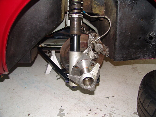

Dan,

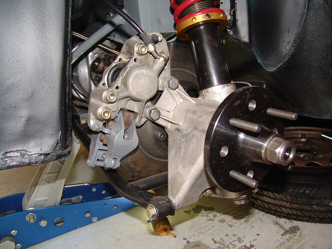

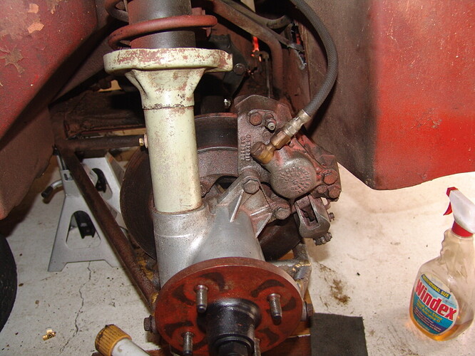

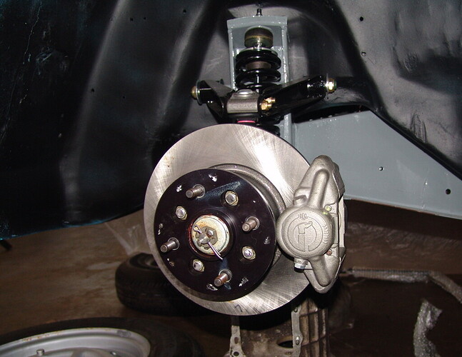

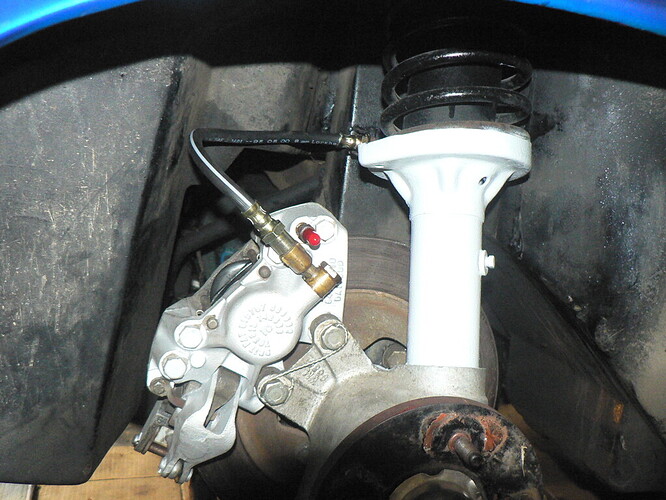

Front arms on the early cars are black, sway is black, calipers natural, castings natural, The early cars used different colors on the strut tubes ( green-gray, gray, black) and lower rear control arms ( black & silverish) - attached are some pictures to give you an idea of what was what plus what repaint looks like.
For paint i use por15 ( gloss) and PPG DP epoxy ( satin) both are pretty durable. I leave the alloy natural ( castings and calipers ) i also leave iron calipers natural or painted silver or clear.
George
Just a note, but I see that you have not installed the sprial protectors to the flexible rear brake pipes on the s1
