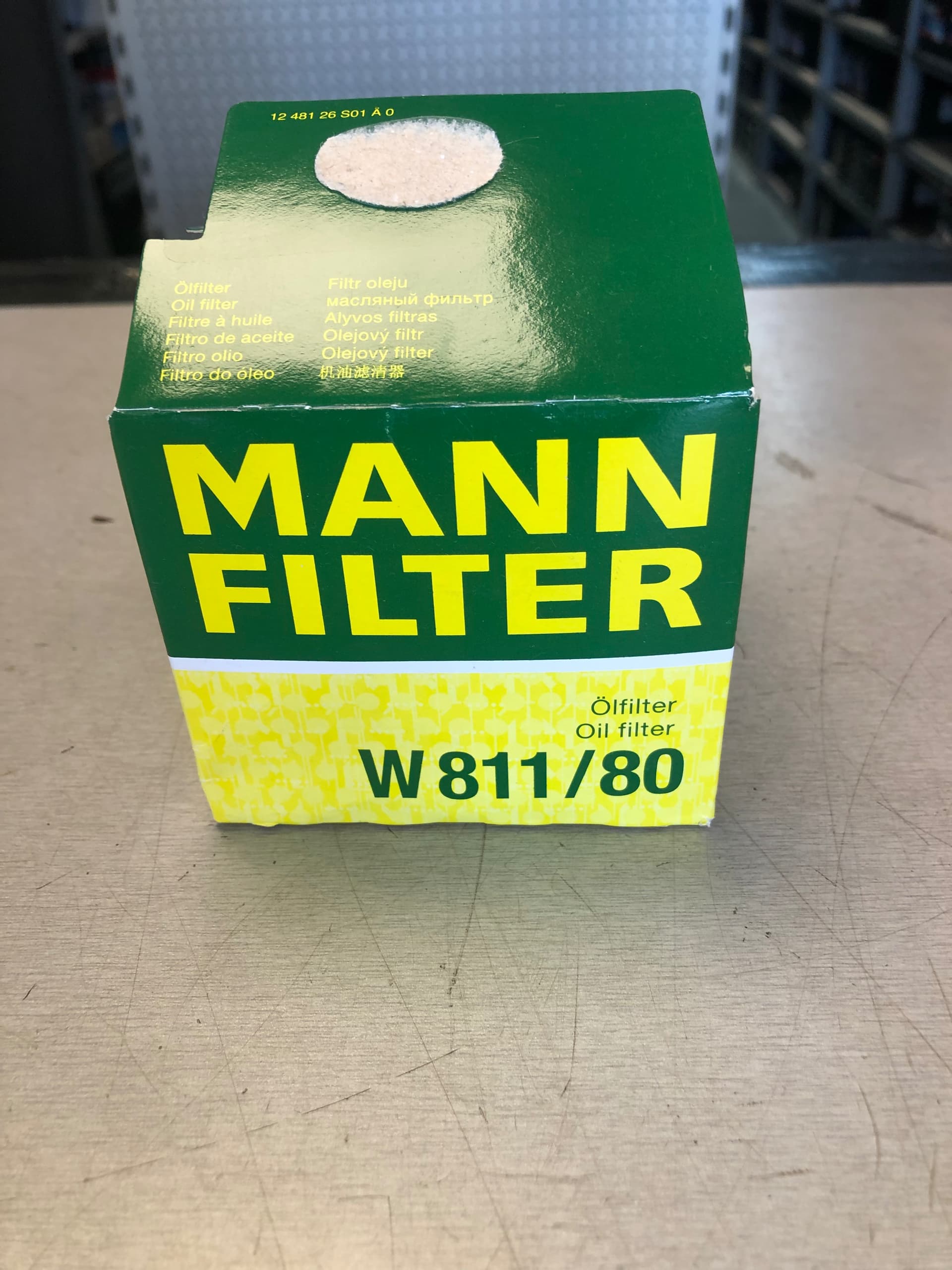

Still a bit confused on oil filters in uk.I am looking for the Mann filter reference, can anyone verifie if one or the other of these are the correct filter for the twincam photo attached.These are 2 references GSF car parts gave me but im not convinced.I get the feeling 1 of those is a mk 2 Elan with the I think Isutzu engine
According to the Mann website it’s neither of those, they list W712 for the Twincam
1 « J'aime »
Brilliant thanks for that Oldelanman I had a feeling something was not rt and that ref you have given was in my head.
Maybe the ones they told me were for the TWITCAM HaHa :laughing: :laughing:

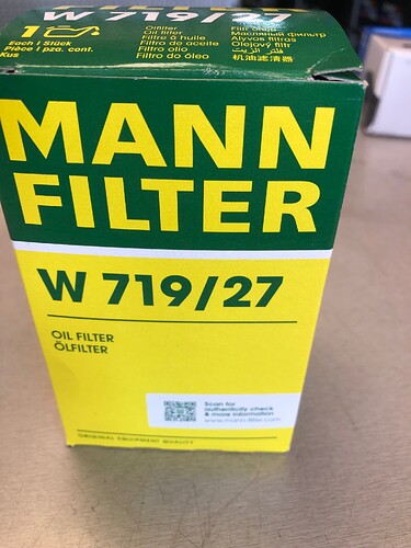

The Mann website is certainly clear that the W712 is the appropriate oil filter for the Twin Cam but it is much shorter than the classic filter that was historically used. (Without measuring I’d say half the height.)
A smaller filter presumably allows a smaller oil flow rate, right? Do the engine experts here have a view on this?
(I’ve previously used the W719/30 which I think is the same as the VW filter mentioned by gboudreaux - Wix 51393.)

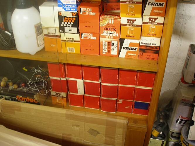

Re the long filter V short filter, I have been using the short filter on my cars since 1980. I rebuilt one engine that had covered 40k miles since its last rebuild, and found NO measureable wear on any component, so just put it back together as it came apart, only cleaner.
I concluded that there is no difference, running wise, or any wise, between the long and the short filter, and continue to use the short. Well, I do have a bit of quality old stock, in stock.
