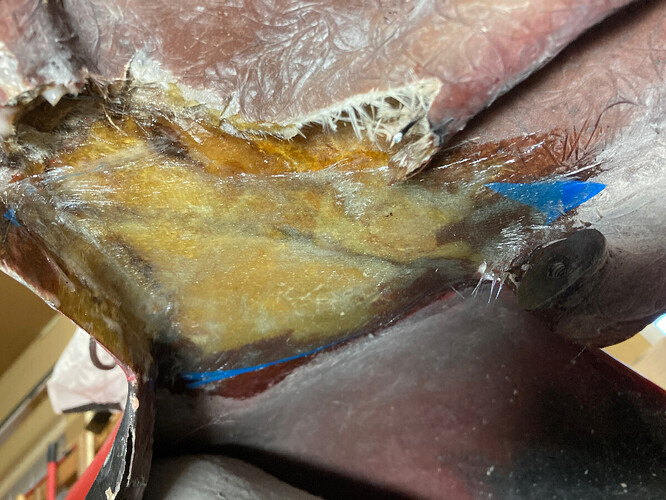

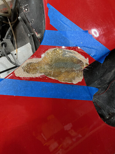

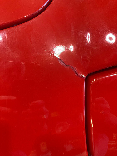

  1. A pretty significant crack between the upper/inner corner of the left headlight opening and the bonnet opening.
  2. Several smaller cracks radiating from both headlight openings.

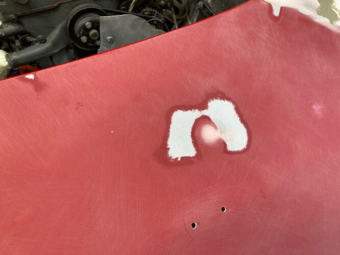

  3. A “dimple” in the bow near the Lotus badge

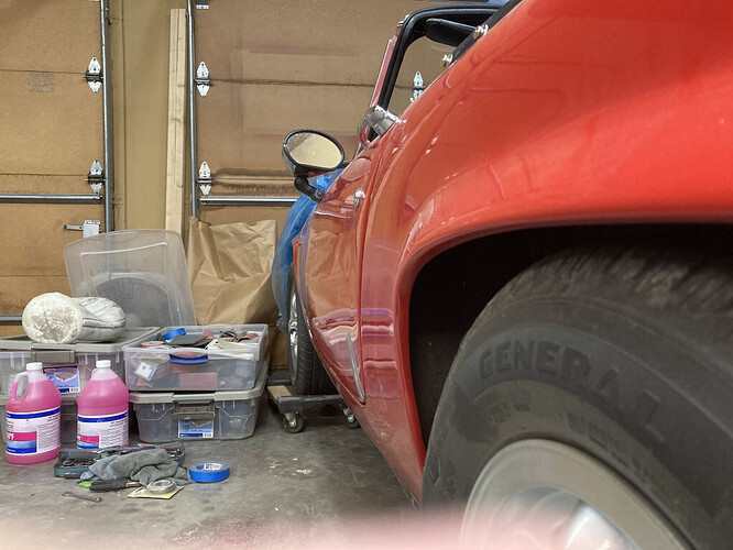

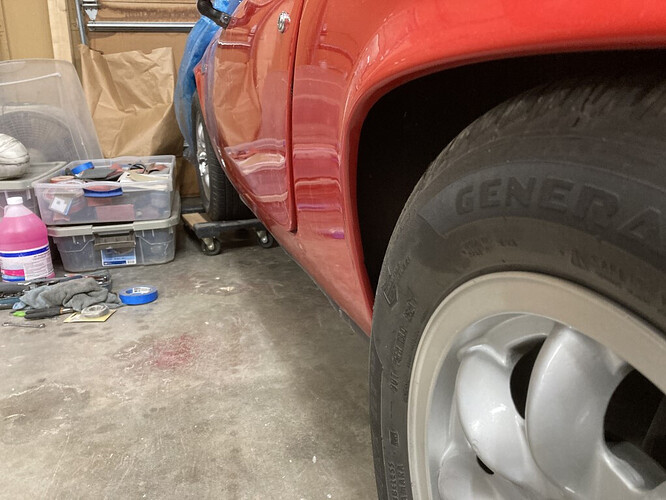

  6. The usual lower rear doors sticking out.

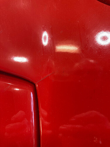

  7. The usual (?) upper/rear of the front fenders being ‘below’ the upper/front of the doors

At the last two LOG’s, Gary Boudreaux held tech sessions on using epoxy and fiberglass cloth options he’s used in aircraft construction for Lotus fiberglass body repairs. Conveniently, I already had some West System epoxy and fillers for sailboat repairs, and Gary graciously gave me enough cloth for the the above repairs (principally #1).

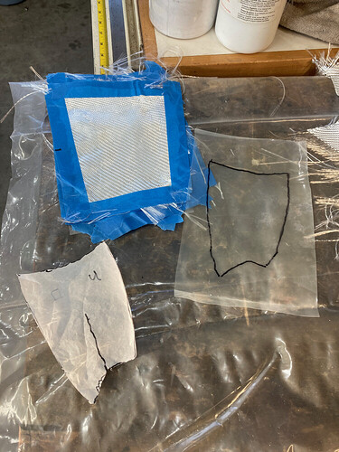

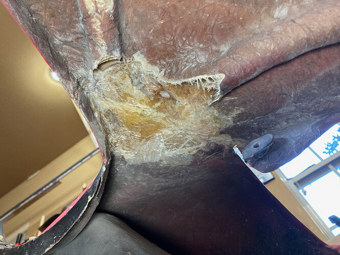

So I started with #1. The plan was to remove the radiator, headlights, headlight raising mechanism, and grill to provide access. Then grind out the reinforcing ribs underneath the crack in preparation for a patch. Prepare a patch of 4 layers of “Ruttan Cloth” wetted out with epoxy, and apply it to the underside of the crack. Let it cure, then grind out the crack from above, down to the patch level. Make out a patch of 3 layers of cloth and apply it to the ground out crack. Then mix up some epoxy and micro-balloons to about the consistency of wet peanut butter and apply it to the cured surface. Then sand that back down to the body profile. Finish with some glazing putty for any pinholes, then prime and paint.

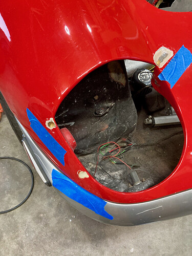

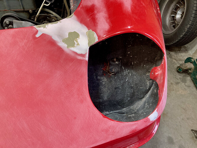

For the smaller cracks, grinding revealed that they were in the filler above the mat. So for those I used patches of “deck cloth” wet out with epoxy, covered when cured with the micro-balloon mixture, sanded back down to the body contour and then primed.
The dimple just got a filling with the micro balloon mixture, etc…
The bumper scratches and rock chips, as well as the chips on the front end, just got some glazing, sanding, and priming.
Re: the “Ruttan” and “deck” cloth. The Ruttan cloth is 7 oz/yd, so quite substantial and strong, but also drapes and conforms exceedingly well. The deck cloth is 1 oz/yd, and a very tight weave that replaces the use of tissue. Both are available from “Aircraft Spruce And Specialty Co.” - aircraftspruce.com
Epoxy resin is preferable to the polyester resin that Lotus used due to it’s much higher adhesive strength, as well as the fact that it doesn’t shrink over time - so fairing compounds made out of it (i.e., the micro-balloon mixture) don’t expose the weave over time.

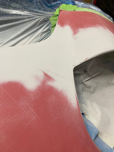

So at this point the front end is ready for paint. Next up is going after the lower-rear door issues.

Now it’s on to fixing the classic Elan bottom/rear door stick out issue.
But is it an issue if it came from the factory that way, and in its 50th year? Given all the other upgrades I’ve done to the car - cv axles, alternator, massive radiator, electric headlight lift, etc., I might as well upgrade this ‘feature’ as well, especially give the other body repairs I’m doing over the winter.

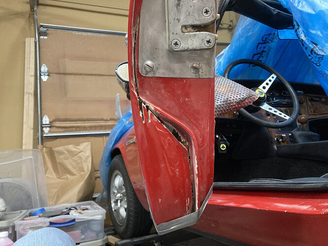

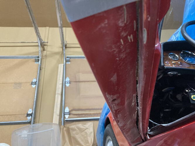

I’m doing the standard “split the outer skin from the inner frame, make enlarge the cut width to = the amount the skin needs to come in to be flush, and fiberglass it in place” approach.

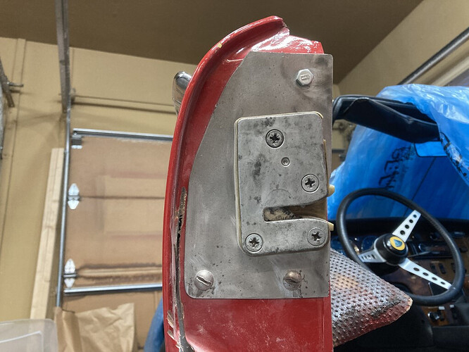

I’ve heard of two strategies to doing this: 1), scribe the door bottom to indicate the cut, remove the door, cut out the scribed area, fiberglass and reassemble; and 2) make a jig that fits the vertical profile of the door skin, with two long bolts that then pass through holes you make in the skin and frame, then tighten the bolts to pull the door skin in, making the slit width larger as needed.
I had issues with both these approaches, basically about getting the modification depth correct. With 1), the cut is made off the car, and you won’t know if it’s correct until the door is remounted. A lot of work to do if it’s not right. With 2), you’ve got to have the window out, which means you can’t latch the door, so again, how do you know you’ve made the correct adjustment?
My approach was to make up a sheet metal plate that matched the back end of the window frame, that allowed me to attach the latch with the window removed. I could then mount the latch to give me the same ‘stick out’ that I had originally, make the slit, move the door skin in, close the door, check the adjustment, and repeat as necessary until I got the bottom/rear flush. A piece of duct tape is all it takes to hold the outer skin in place. Then glass the outer skin in place.
Earlier this week I made up the latch attachment plate. Today I cut the slit and adjusted until I had the bottom/rear flush with the fender. There’s still a bit of a ‘bow out’ around the door key area, but if I feel compelled there’s enough door skin thickness to work with to make that flush. The bottom edge is a bit proud as well, but that’s not very prominent, so I’ll just let that go.
Next to do, fiberglass the skin in place, and hide all the evidence of my butchery.

Before you fibreglass up the door, if you haven’t already done so, I suggest that you refit the window frame to check that there is still enough space between the door skin and the bottom of the frame, especially in the centre where the pulley bracket is located. On my S4 LH door I can not get my fingers fully between the bracket and the door skin, and the door is still standard.

Thanks, that’s certainly the plan. My pre-cut measurements indicated that there was plenty of room for the .25" adjustment I needed.

I got around to test fitting the window frame today, and took some measurements. With the outer skin pulled in, I measured .81" of clearance from the outside of the frame holding the pulley to the inside of the door skin. My adjustment amount was almost exactly .25". So at least on my door, there was about an inch of adjustment available. Re: the “finger test”, I could just get my fingers wrapped under the pulley and between the door skin, with some space to spare.
Clearly there was quite a bit of variation when they built these cars!
Steve
BTW - does anybody have a trick for getting the top bolt fastened to the rear of the window frame? There are 3 fasteners for the window frame rear plate, the bottom 2 are machine screws that screw into nuts glassed in to the inner door frame, but the top one has no captured nut, just a hole, and I can’t figure out how to hold a nut in that spot, much less get a wrench on it. Apparently neither could the PO, since there wasn’t one there, on either side, when I got the car.
