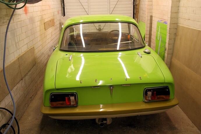

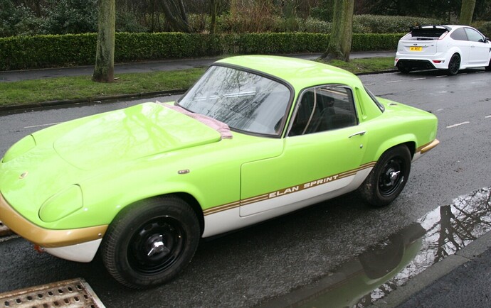

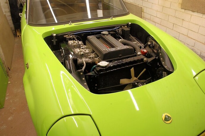

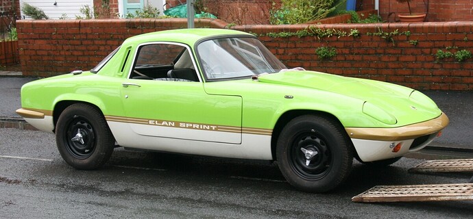

This is my first attempt on here with pictures so here goes, This is my Sprint FHC which I have only owned for the past 41 years! I have for far to long been trying to restore it but after a few problems especially with the paintwork I lost confidence in it and pushed it to the back of the garage and put a cover over it.

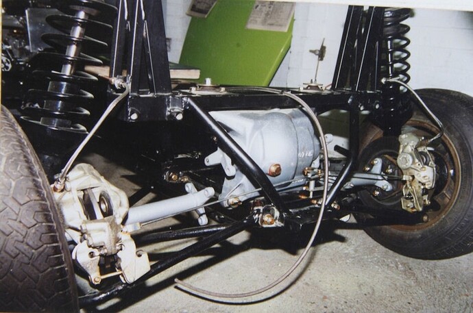

Now after many years my two daughters have made me see sense and get it back on the road. I did manage to rebuild most of the chassis and re-trim the interior but I have found quite a few gel cracks have appeared and therefor have decided to send the car to SMS at Spalding for it to be sorted.
The chassis has had every nut and bolt replaced and many bits powder coated, most non stressed nuts and bolts have been replaced with stainless ones. The brake pipes, fuel line, clutch pipe and oil pressure pipe are made from Aeroquip Stainless with all stainless connectors. These were made up specially for me by Banks Service Station in Southport.
I replaced the fuel tank many years ago with a Spyder aluminium one after the usual rusty bottom of the original started to leak.
I will post more information on my restoration shortly.
Thanks
Ian
Good to see another one coming back together!
Looks like a great job - well done :smiley:
Absolutely lovely! Only the 2nd full Pistachio Sprint FHC that I’ve seen :slight_smile:
It will be a joy to have back on the road.
Ian
Well done, top colour.

I think one or two think from my pictures the car is nearly finished, the chassis is pretty much done however, the photos show the car in really good condition which is not really how it is. There are a few cracks in the paint and in places you can see the fibreglass matting showing through. I think I should have put more polyester spray filler on when I started the respray.
The car is going to SMS in Spalding next Tuesday where it is to have a complete respray, I’m hoping that will be the only major job but as the car hasn?t been started for quite some time I have my fingers crossed the engine will be ok. Last time it ran it was filled with Millers Classic oil and the water had special anti-corrosion additive added.

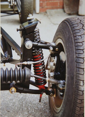

ACOUPLE OF PICTURES OF CHASSIS PRIOR TO FITTING

Congrats Ian! Great to see another on the road again. And good job posting the pics. We all love seeing pics. Then we all can tell you what to do !!! Ha! For instance, great chassis pic but it seems to be missing the rear donuts. Don’t forget to replace them. If they’ve been sitting for years, replace them. For that matter, get rid of them. Go see Susan Miller or one of the other fine parts vendors.

With reference the chassis Frank, the photos are early ones (pre Digital) and since then all dounuts are now fitted as is brake pads etc. I think its certain I’ll be getting rid of the current drive train and replace it with something like the Sue Miller one. I spoke to Sue recently and she tells me she no longer builds these and has passed them over to Pat Thomas at Kelvedon. I do see Paul Matty does some and from what I read they’re the Sue Miller ones.

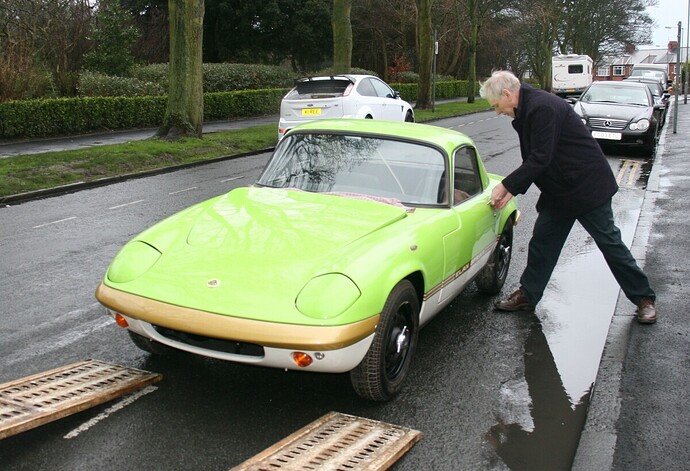

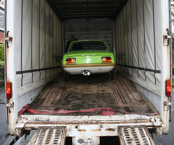

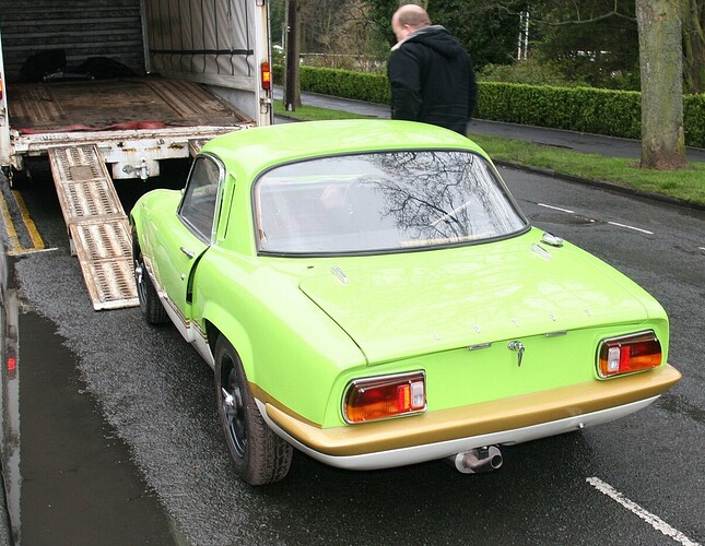

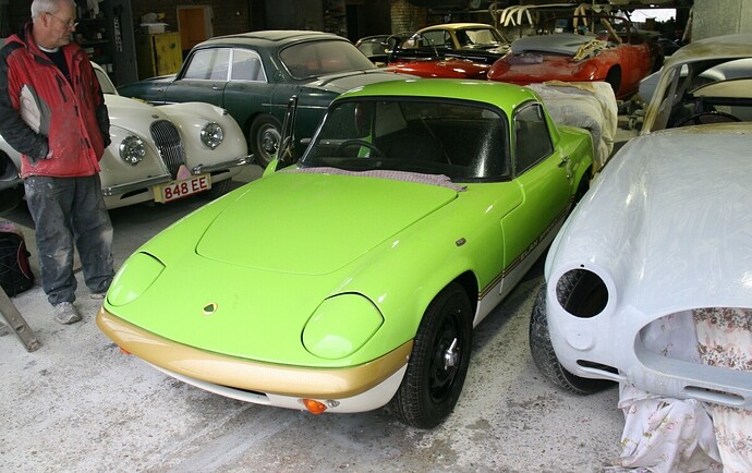

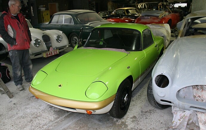

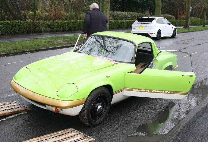

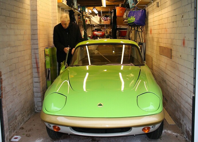

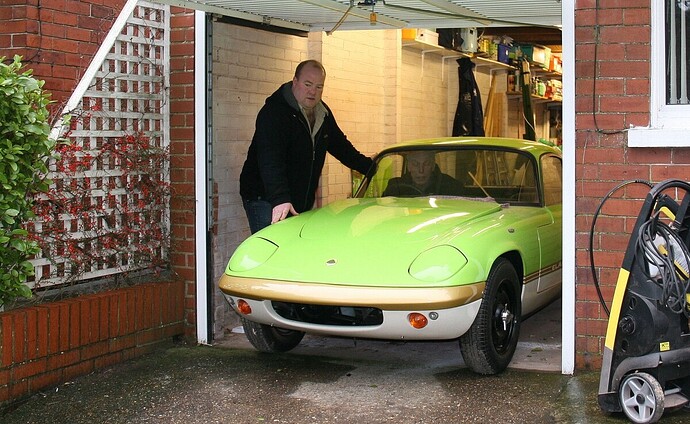

Well today was the day my car saw the light of day for the first time in at least five years! and what a day, heavy rain and high winds. I was lucky to have a local transporter with a covered truck so the car was kept dry for its 140 mile trip to SMS in Spalding Lincolnshire. I have attached photos of the move.
GETTING READY FOR MOVE OUT OF GARAGE
BIT OF TAPE REQUIRED TO HOLD DOOR CLOSED!!!
LOADED ON WAGON
FINALLY AT SMS WORKSHOPS TO JOIN AT LEAST FIVE OTHER ELANS

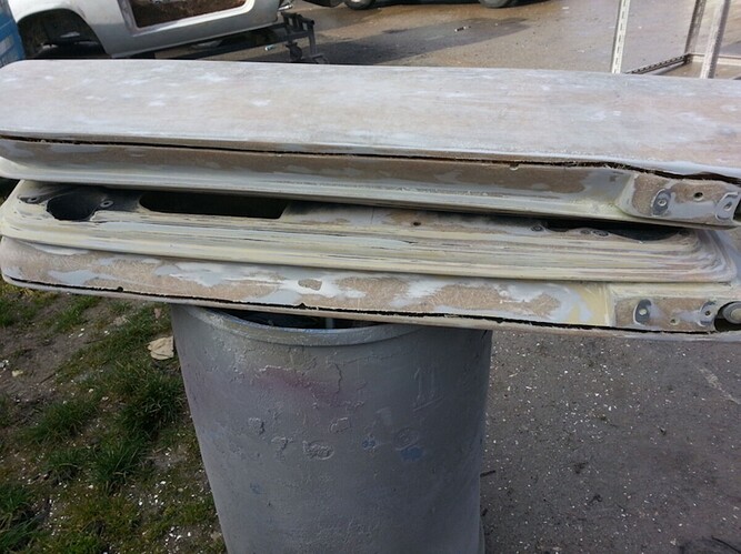

The paint is to be stripped and all gel cracks repaired along with ‘cut and shut’ of door bottoms suffering the usual problem of bad fitting because of old Lotus moulds. I will keep you all up to date with the rebuild, please feel free to ask any questions.
ian

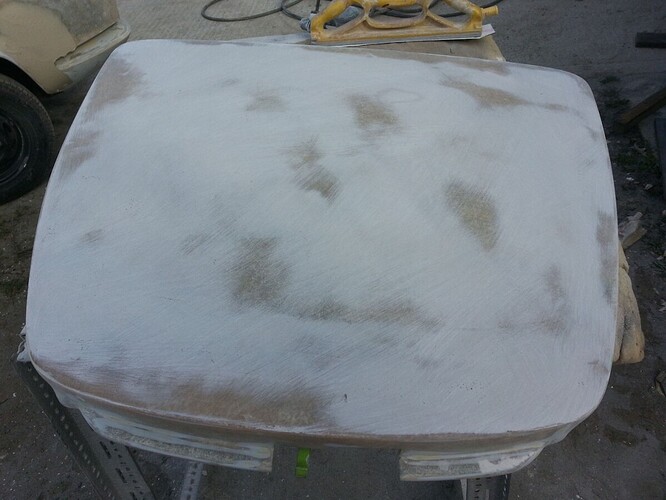

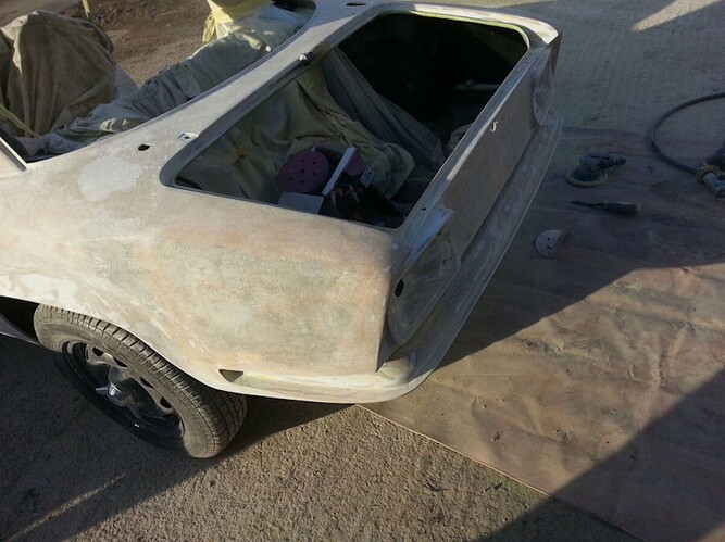

Have just received some photos of my car from SMS, looks as though they are getting on well.

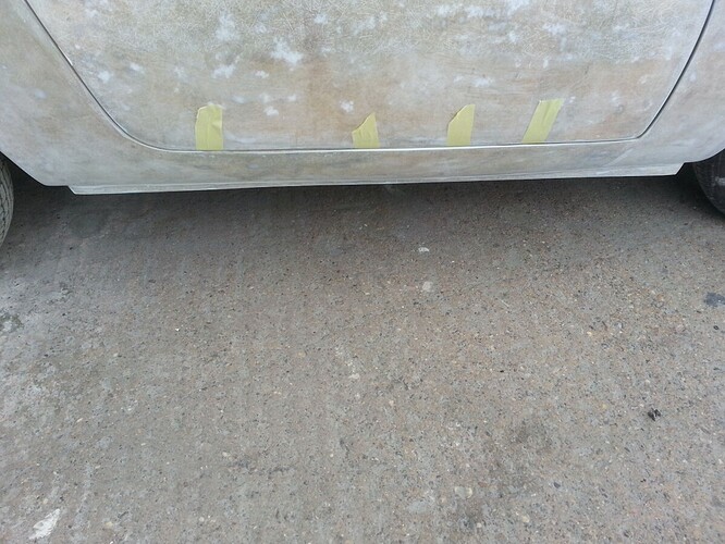

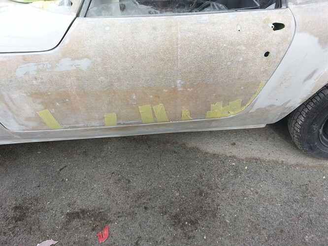

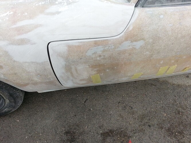

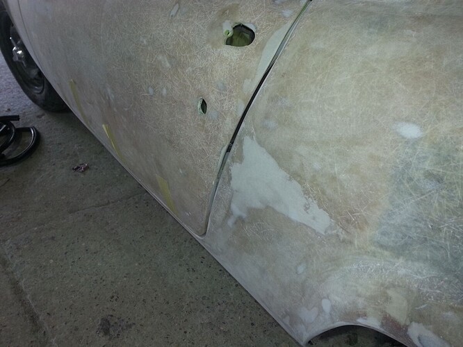

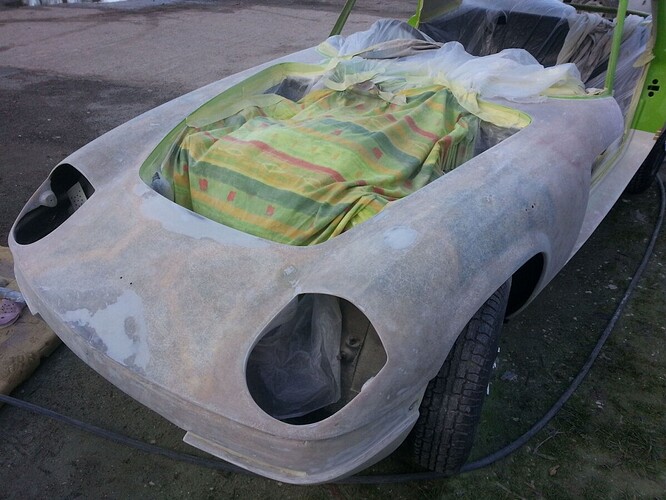

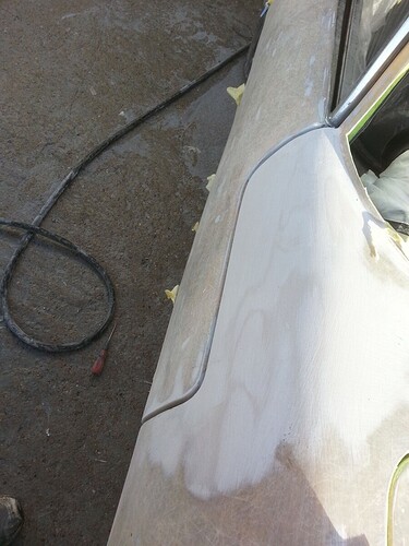

1st March and some more photos from SMS on the bodywork, they are currently working on getting the doors to fit correctly. As most know the Sprint doors are well known for not fitting so the guys at SMS are doing a ‘cut & shut’ as can be seen in the photos. They also tell me the top of the doors have had to be done also.
I have some more shots of headlamp pods & bonnet which I will add soon.
Ian
Great fitting doors. You’re doing it right, ie, make the seal fit the door, not the other way around.
Greg
Yes Greg,
One of the reasons I went with SMS is they do everything correctly, I’m also impressed with the contact. Mick who is one of the two owners is doing all the prep work and keeps in touch with updates and photos.

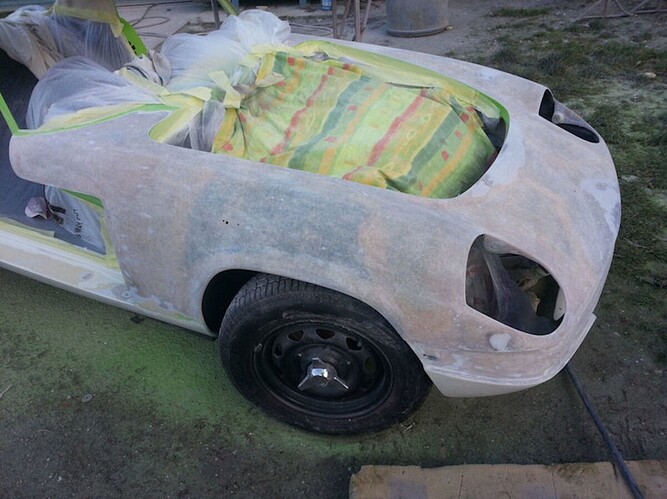

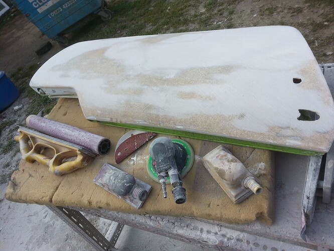

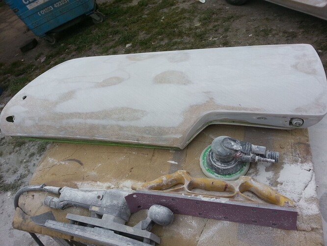

A few more photos of preparation of doors and other bits prior to painting, have just been ordering a few parts ready for rebuild from Sue Miller which arrived within a day!
Thanks
Ian

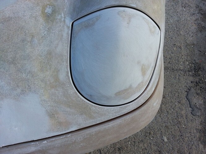

maybe a stupid comment: why are the front lights (bodies thereof) still mounted?? the final result
may be (let?s say) questionable, to say the least. ------------- or did they just re-attach them for their
“works-photo”??? or am I just being cynical? cheers sandy
Sandy, looking at them I’d say they’re working on getting all the contour lines correct as when I did a respray on the car I can’t remember putting any filler on the light pods. Having seen their attention to detail there’ll be a reason believe me.
