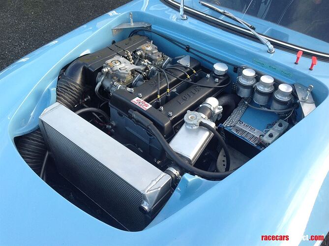

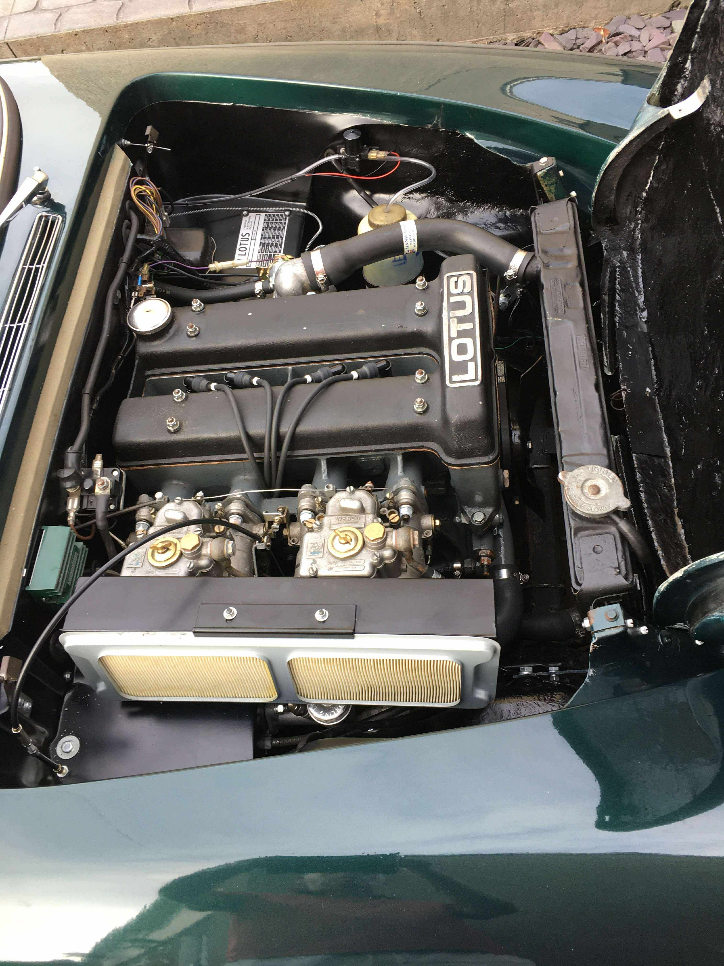

FWIW, your Elan will probably go better with the original intake system, and will sound quieter. The Escort had a lot more under bonnet space than the Elan. You want nice cool air for the intake, and there is the benefit of a small pressure boost if you are drawing air from the plenum.
When I was still competing, I spent quite a bit of time nosing around the pits at other Elans to see why they were faster than me. It turned out it was the ‘nut behind the steering wheel’ at fault, but I did notice that everyone used a plenum mounted filter, trunking and airbox - albeit the larger TTR style airbox that didn’t shroud the rear carb inlet.

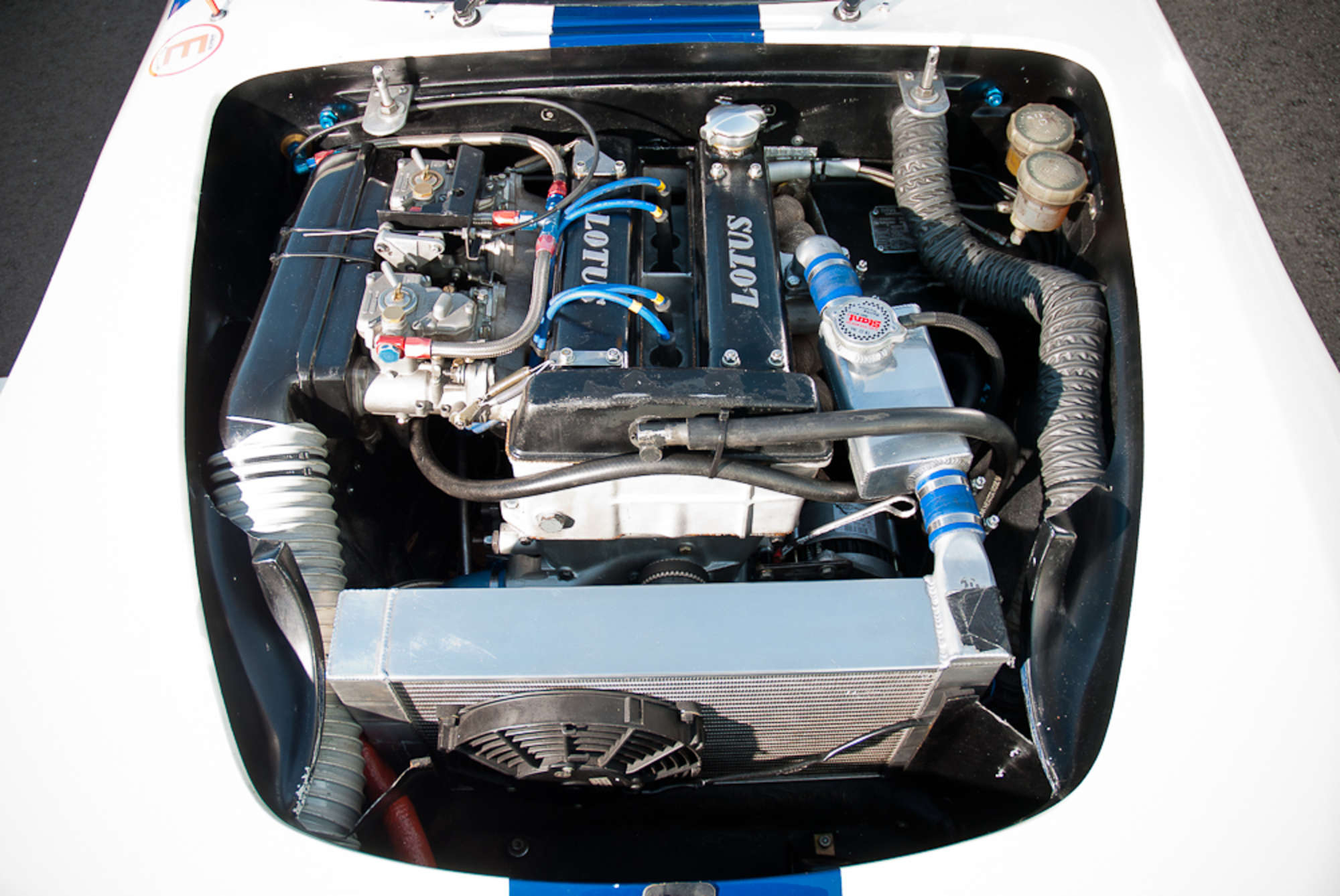

Edit: Just FWIW, a couple of GTS style competition Elans off the web -
