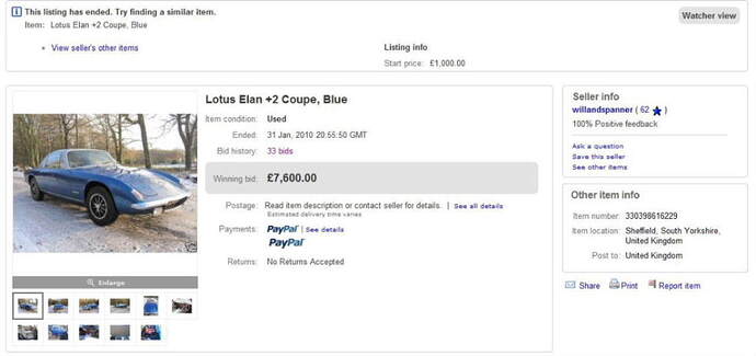

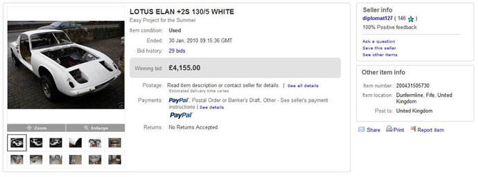

Hi
This is interesting; 2 cars sold recently, one in boxes and the other complete, both very nice cars.
Both made good money (which they deserved) but, until recently a car in boxes at this time of year would have only made the price of the engine. Are prices finally coming up and the +2 will make the money it deserves? Maybe the +2 is getting rarer due to all the ones broken on Ebay recently, buy them all quick. :smiley:

The two cars on ebay really made a fortune. Well, good for the sellers…
