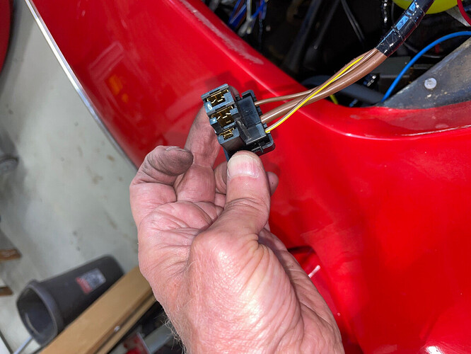

I am still rewiring my '69 S4 DHC. I have come upon a mystery that is not addressed in the wiring diagram I am using (an excellent color diagram I downloaded from this website).
I am replacing my original, fully-bodged, wiring with crisp, clean wiring harnesses from British Wiring. Unfortunately, I am unable to identify a bunch of stuff, including this plug:
As you can see, it emerges from the wiring loom in the compartment in front of the radiator. I am not finding a male analogue and do not see where these wires appear in this area on my wiring diagram.
Many thanks!
-John
Alternator plug, and thick brown are the charging wires (possibly fiting a Lucas ACR 17 I would say, it looks quite similar to what I recall I had to source to fit one)
Yep - plugs in the back of the alternator
Perfect! Thank you, that solves two mysteries.

the wiring of the alternator itself should not be difficult, as it contains its own regulator (as a proof, I don’t recall much of it when retrofiting one on my 1968 S4se… or what is it a proof of?):
  • the thick solid brown is the main charge wire, and should end up to the battery positive at the starter solenoid
  • the thin brown/yellow is the dash light
  • then second, thin solid brown… I believe it should also be connected to the battery positive (doing a retrofit on a dynamo harness, and willing to keep the RB106 dynamo regulator for looks and reversibility, I did that on the terminal A of said regulator, which was partially disconnected to act as a terminal box)
