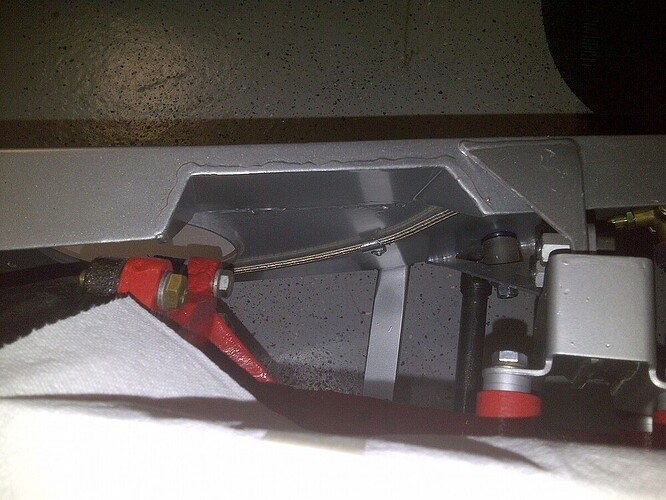

Here are examples of chassis mods from the wiki:

The comment about distortion is well taken, perhaps I am asking for trouble with a significant amount of welding in the front towers. There is a picture of a TTR prepped chassis out there with extensive welding witness marks around the front tower where a sealing plate has been welded in, but perhaps that was done while the chassis was still in the jig. I may investigate other ways of sealing this area.
