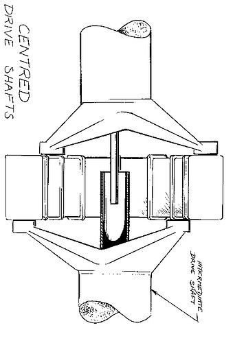

Cars already in Service can be fitted with the new shafts, preferably in FULL SETS (6 shafts per car).
The new shafts can be identified by study of the illustration overleaf. Inboard and outboard drive shafts have a spigot from their centre, on the ‘spider’ side. The intermediate drive shaft has a tube at each end, on the ‘spider’ side, into which the spigot of the inboard and outboard shafts fit.
