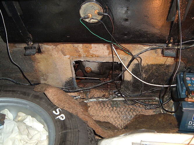

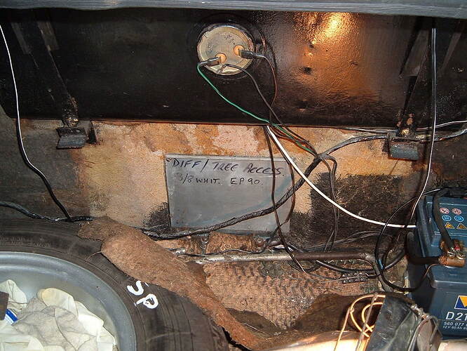

P.S. access plate and access hole photos…

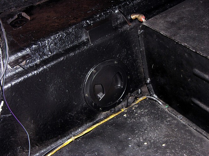

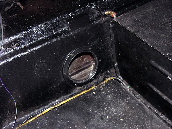

Seeing that access hole tempts me to do the same on my +2 standard lotus chassis. It would make changing the rear oil seal on my 4 speed a piece of cake.
Is the chassis in the photo standard as well? If so, what about chassis stiffness?
Dave Chapman.
Dave
No such thing as “piece of cake” when talking about Lotus,but yes,standard chassis,no problems regarding stiffness-just ask the wife…
John :blush:
P.S. it was only last month that I “battered” a hole in the boot and fitted a door to get at the handbrake tree…makes life so much easier…

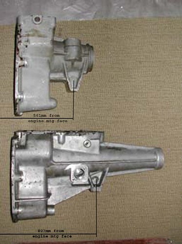

I have modified the 4 speed gearbox mounting plate by removing the reinforcment pieces and turning it through 180? in the chassis. The chassis has two sets of holes and with two new holes in the bracket it places it the required 96mm rearward compared to the 4 speed position. The new position is only 25mm from the start of the chassis box section, therefore, when you look at the picture I?ve found of the +2 and Elite 5 speed box tail sections, and scaling the different lengths, it is clear that the Elite box won?t fit the Elan.

…I know,i spent lots of time,effort and money altering the Elite tail section (and moving the gear lever) to mimic the Ford tail section just to fail at the last hurdle…I couldn’t stuff it into the frame box section!!!
John :wink:

Now severely tempted - I might just go for it. The pool of oil in the chassis will help lubricate my jig-saw… :sunglasses:
Thread diversion over…
Dave.
There’s a small pool of oil under my Elan in the garage - nowhere where oil should be. The penny dropped - my car has been jacked-up at the front for the last 5 days and the pool of oil is right under the rear end of box section.
I knew there was a nice film of oil in the box section, but not enough to drain off. :open_mouth:

Regarding a hole in the boot - this is the best I could do to eliminate the frustration of filling the diff:
Great idea Brian, never thought of that! I have been covered in diff oil in the past; not very pleasant, cheers, John.
…or this which gives access to the handbrake tree also…
John :wink:
