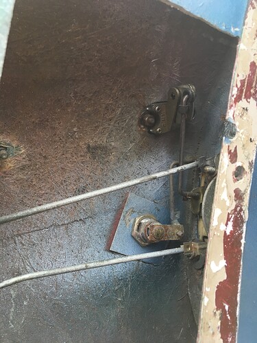

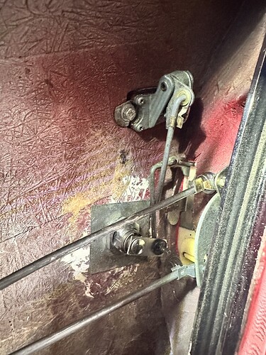

Does anyone have a photo showing how the rods on the door latch connect. Check the manual but it doesn’t show them connected!

I spent hours a couple of weeks ago refitting these rods. It’s like ‘papering the hall through the letterbox’ until you find the easy way to do it!
Thanks Alan, I’ve looked at this one and it’s a little vague where the rod (42)connects to the door lock mechanism but thank you :clap:

Cheers for this, it’s that top rod the long one to the internal handle I couldn’t remember what it attached to. Thank you

Yes it can be a pig to fit. The easy way is to attach to the latch mechanism THEN fit the latch.
