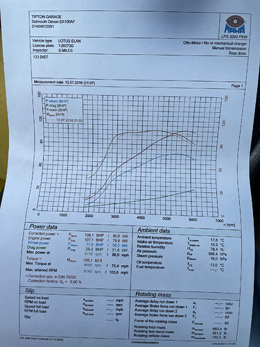

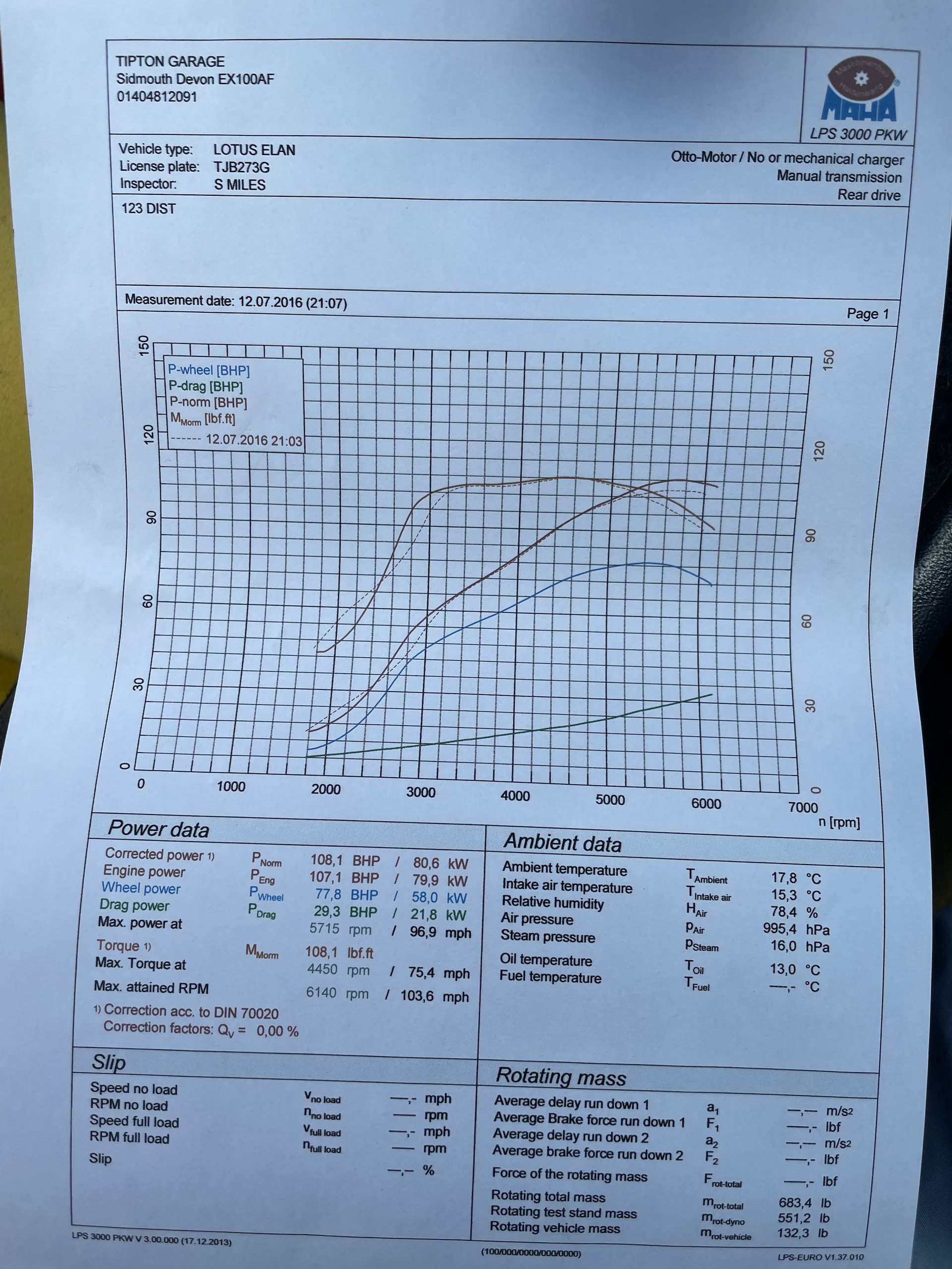

That is my dyno recording above and down a country road my car feels plenty fast enough.

the dyno chart is interesting, because that looks like a fresh base engine, so good to hear that it is plenty fun. Albeit that is such a subjective thing. I track a 996 GT3, for reference. But I also have fun in my GTV 2000. I think I just need to test drive one personally and see if a stock Elan is the fun I am looking for.
