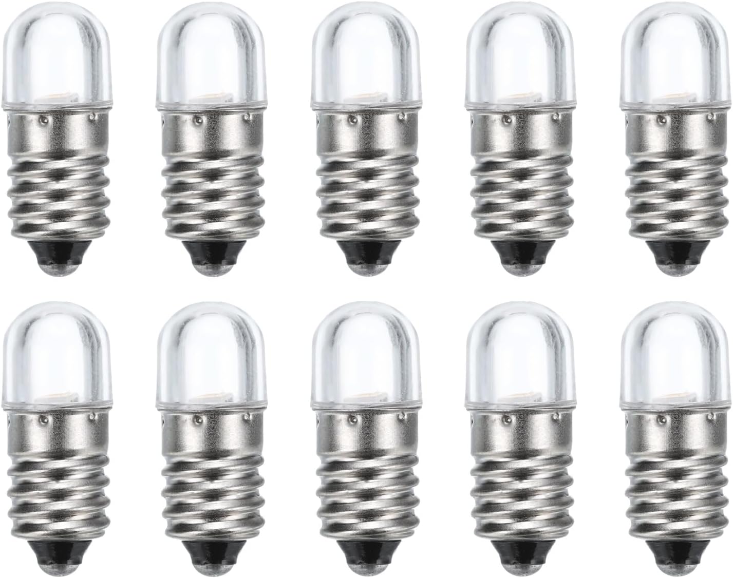

My original incadescents were woefully inadequate in the city at night (Denver). Perhaps away from traffic and street lights they were barely adequate, but otherwise pretty horrible. When I switched it made all the difference in the world, regardless of where I was. I just bought them on Amazon GutReise 10pcs E10 Screw DC12V Warm White Spot Led Bulb Light Lamps +10pcs E10 Base (DC12V, Warm White) - Amazon.com I didn’t change the flasher, but I do remember a minor issue with fitting one, though I can’t recall what that was. I have no hesitation whatsoever in recommending them, it made all the difference in the world- perhaps some bulbs acquired in the UK gave people problems, but not for me. I also changed the dashboard and license plate lights, the interior light really does its job now contrary to the relatively weak output from the incandescent version. I also didn’t need any adapters. My bulbs look nearly like a regular bulb save for a white plastic ring collar near the screw base. Now that I think of it, on one bulb- I think I carefully sanded down this ring a hair to make it fit easier, but overall, it was a simple swap. The cost of the bulbs was merely $10 for 10 of them.

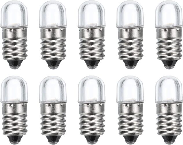

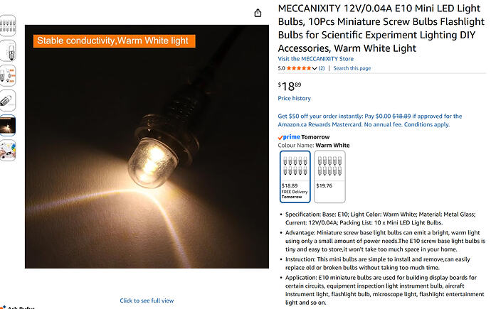

One of the few parts that I don’t mind sourcing from Amazon is LED bulbs.
These ones work just fine and I keep a spare in the glove box just in case. The only two that I have left the incandescent is the charge warning and cigar lighter (heat)
