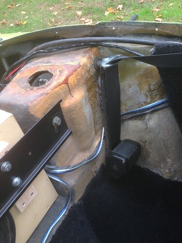

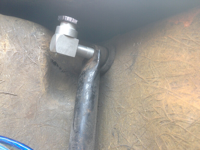

I am trying to fit inertia seat belts into my Elan S4 Looked at lots of post on hear about this but have come again a problem. a good solution would be to fit the Spyder Conversion kit but go in touch with Spyder who said theyu are closing, have no stock and cannot give me the name of the company taking over production because the deal was not done yet.

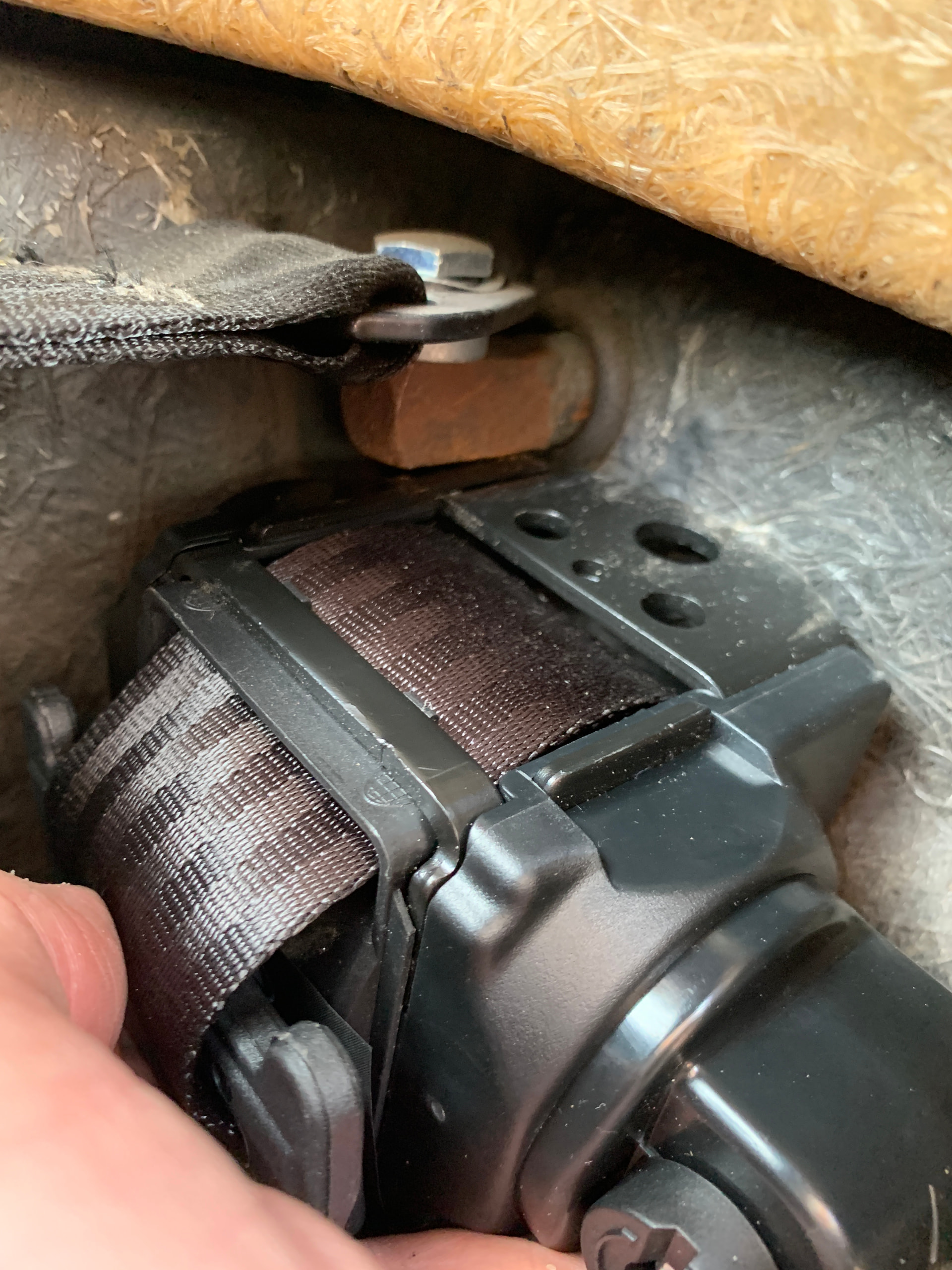

One of the treads on here suggested using Securon 514/30 be;ts that would fit opto the existing brakcet at the top of the suspension . gotr som of these but they do not fit, there is not enough room to the body to allow the holes to line up. See photo.
On some of the photo’s on here ther is a rod from this top fixing to the reel which is mounted lower the belt goes through the top mounting, but i cant find a supplier of these brackets ,see photos.
Any help suggestions would be well recieved,
