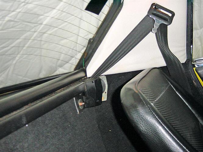

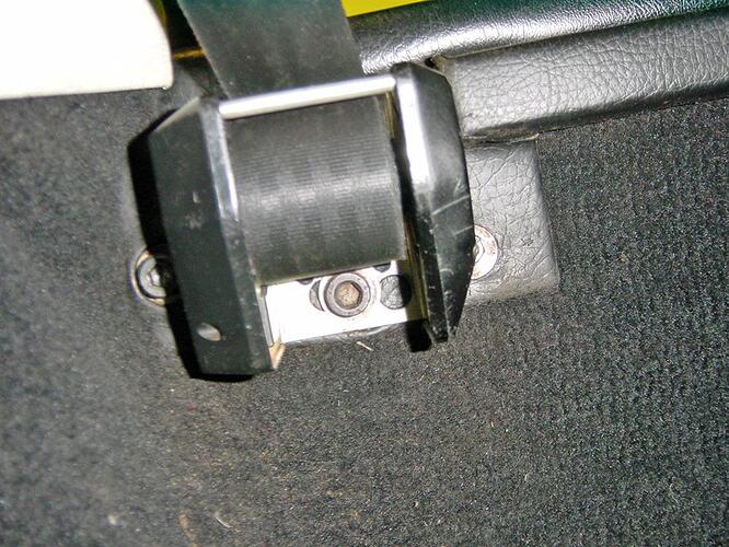

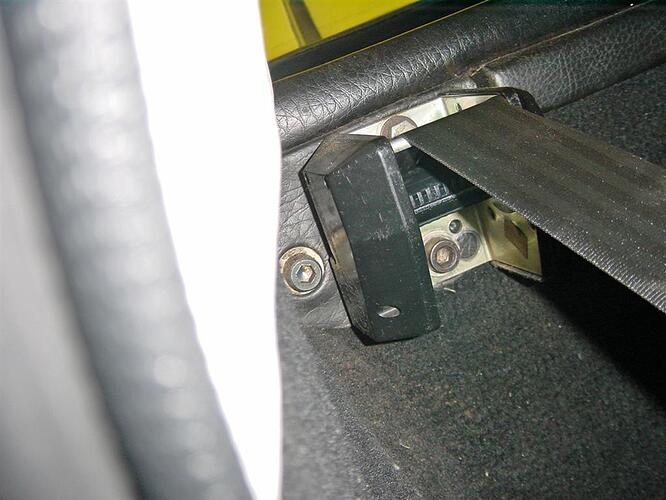

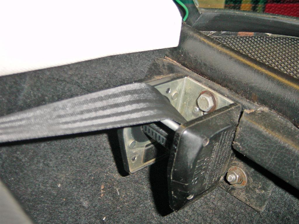

I fitted I.R. belts a long time ago to my Sprint so the memory is a little rusty and I cant remember the exact specifics of the job.
Basically I made two plates with a square section tube connecting the plates, the plates were mounted to the top tower bolts holes and the seat belt bolted to the plates, I then covered the plates and connecting rod with a black vinyl material…the pics make it a little clearer.
It does not have a top mounting if that is what you mean and I hang the buckle on the coat hook for ease of use, the lower end of the belt is attached into the mounting point in the sill.
