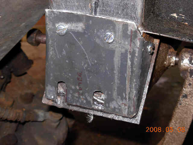

How I repaired my rusty front suspension turrets.
In early May, I found to my horror that I had not been keeping my drain holes clear and my front turrets had rusted to a thin shell that I could easily poke a screwdriver through.
NOTE: the turrets LOOKED OK until I poked, so try poking yours too.
I set about repairing the turrets by making steel patches and having them welded on for me. For the full story, click this link:

This picture gives a one-shot summary

Good morning Bill
Whilst it looks like you made a good job of the repair, i think this chassis was calling TIME UP! After all, it doesnt owe you much 30 odd years on. And if you dont mind me saying, the front brake hoses look a little tired too.
All the best,
Leslie
Had there been any significant rust in any other place on the chassis I would have agreed with you, but at my age, tight for cash and with all the other things I want to do (like move out of London) I really didn’t want to take on a task of replacing the whole chassis, which last time took around 6 months total.
I feel sure that this ‘repair’ is stronger than the original and certainly less likely to accumulate more crud & rain water and cause rust in the turrets again.
It should last longer than me now. :smiley:
Note that it was important to weld this patch on BEFORE the turret broke or twisted, so that the chassis geometry was still OK. Had it broken or twisted, it would have been necessary to take the body off to be able to put a patch on and correct the geometry, which then of course would not be worth while; then it would make more sense to get a new chassis.
Bill, hopefully you poured POR-15 or something similar down the turret to prolong the next ‘breakthrough’. Get a brush with a long handle and slosh it around for good coverage. Do the outside, too.

Not sure what that stuff is, possibly a USA name.
I was liberal with some stuff called Jenolite which is one of these rust conversion liquids. Contains stuff like phosphoric acid.
Also the Hammerite is a paint designed for this kind of work, to deter rust.
