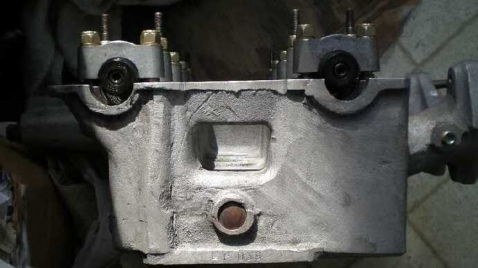

Take a look at to rear of the cam, the end that doesn’t have the cam sprocket on it. May give Ken at QED a call and ask for the clearances but the clearances you gave would be a good start i would think.

Gary - good photo, Did Beau hold you by your ankles to get the upside-down shot?
Could it be that they are reprofiled ordinary cams and so they dont get marked up as such?

I had the photo in stock, there was no running around to get it. I did have to remember where the hell it was on the computer so that I could edit it and turn it 180 degrees in MS photoed and then send it off to photobucket where most of this trash gets hosted from. Yes, its free account that they will give out to anyone all you need is a 100 dollar camera and a dial up line (15.99 a month, 28k bps, a screamer - as thats what I do when the pop-ups take over) an you can be a ace spewbag too.
The cylinder head is the Kenny Duclos built head from the rebuild of 26/4597 from 1996. When it went on the dyno all was going well and it was making 100 hp at 4k (from 1700cc) and at that point Kenny noticed that it was pissing oil out of the spark plug valley from the cross feed oil gallery and shut it down. A phone call to me was made and a suttle statement was made “I’m done with your engine, You need a new head. Come pay the bill and pick it up or buy a new head and we can finish it.”
So this is the old head that was eventully repaired when Kenny had the time and it been on the shelf since 2000 waiting for the next project. It was to go atop the AX block that you have now along with a set of 85mm JE pistons that I have but as you know, finances got in the way of that plan. It will probably will make 170 hp with 1760 or a bit larger displacment and was to get dropped into a Cortina for a bit of old fart at play fun. It’s still going to happen, if by the time I can afford to finish the project I can remember which way to turn the stupid wrench (what the hell is this cold piece of steel and why am I holding it?).
This is the Kenny head on the floor in the kitchen next to the trash bag, there is good light there so I take lots of phots near this location.

“LP 039”…??? Wow, that must be a very early head…??! :open_mouth:
