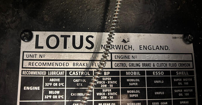

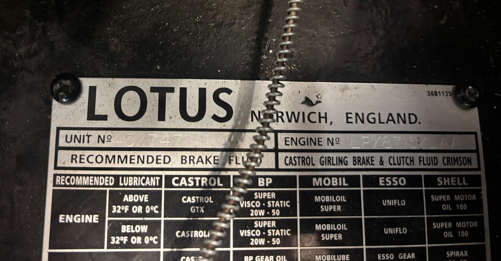

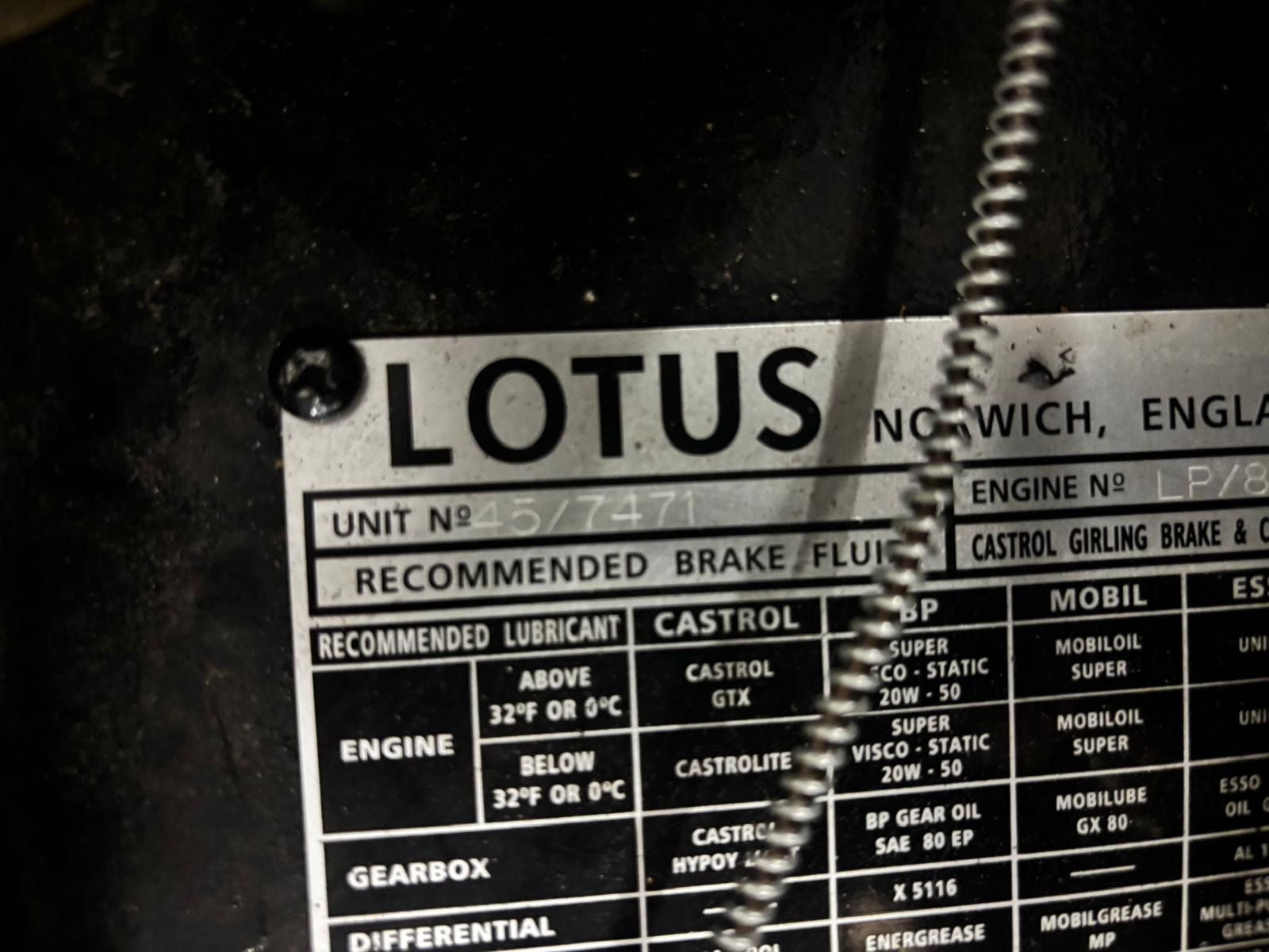

Martin, if you’d let me know what the VIN says I shall see what I have on my register for the Unit No.
Thanks Tim. Its 45/7471.
Thanks.
I have that Unit No, 7471, being invoiced by the factory in January 1968, as reflected by the date of first registration.
Unit No 7895 was the first production Series 4 and that was in May 1968, although the Series 4 was announced in March of that year. There is an outside chance your car might have been a development unit for the S4 body, but my guess from looking at the advert photos is that the current FHC body is in really rather good condition, reflecting the likelihood that it is a replacement.
Is the way the VIN plate is stamped consistent with others of that era? I have images to compare it to or you can search on here. If it is, then your car may well have started out life as a Type 45 DHC Series 3 and subsequently been rebodied. Given that the advert describes a ground up restoration, I suspect this is the most likely explanation. Knowing the Engine No would help confirm this, I feel.
There is another possible explanation, particularly if the VIN plate is a fresh new one that has been punched/scribed in a way that bears little similarity to the factory standard. That is that the VIN has been made up or that the number was from an original part no longer available and the person doing so used the 45 prefix in ignorance of what would be correct for a Type 36 FHC. I am not implying any criminality, rather a matter of just getting it wrong.
Either way, it does look as if someone spent a great deal of time and money doing the restoration and, from the photos, to have made a pretty good job of it.
Plate looks like this. And this
My car is a 1968 S4 FHC. My VIN plate is extremely scruffy and effectively illegible. Your VIN plate looks so good and smart that I suspect it is a replacement.
Richard Hawkins
My '67 S3 and '68 S4 both have the unit numbers scribed onto the plate rather than punched. Nothing wrong with a new plate as part of a restoration, but I would always retain the original. Ask if it has been kept if you still plan on viewing the car.
Thanks for all your help and comments. I am genuinely undecided whether to view or just walk away on account of the uncertainties. I don’t think the ‘original’ plate is available. This was a project that was passed on from a deceased previous owner. So it will just have to be a bunch of unknowns. I suppose anything is a case of ‘if the price is right’ but I have no idea what value to put on this one.
