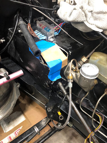

Glass fiber modification done to allow easy heater
Valve swap.

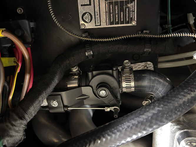

Same here….

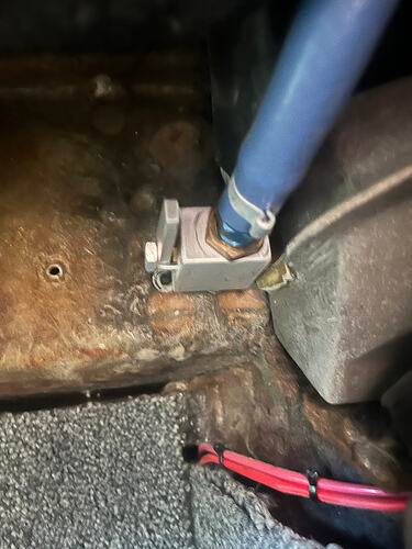

I got rid of the horrible valve years ago and fitted an in-line ball-valve in the passenger footwell. I can reach over and move the lever from the driver’s seat (preferably when not moving!).

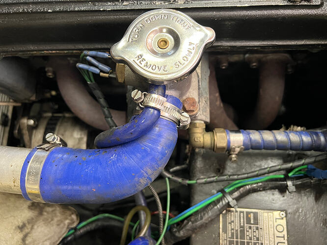

Did the same thing over 30 years ago, and it’s still there, working well.
And that blue hose (multi layer coolant rated silicone sold by Dave Bean back in the day) has been there the whole time. Still flexible.

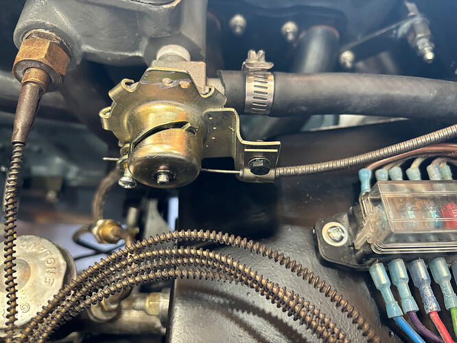

I have used this for more than 40 years, connects right to the heater cable.
