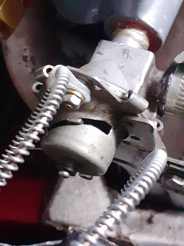

Richard, you can change the internals of the valve without disconnecting the engine mount, you have to drill or cut out the rivet off, rotate the outer cover then disassembly the internals, change with new internal from a new valve you have disassembled and reassemble.
If the inside of the valve is badly corroded then engine mount will probably have to be disconnected.
Picture shows where I changed the rivet with a small bolt nut.
