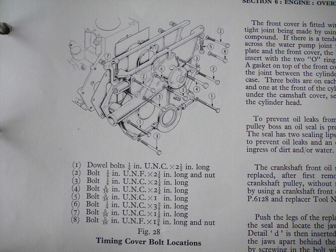

Does anyone know the size of the two bolts at the front of the head either side of the long middle one?
One is a nut and bolt the other a UNC bolt.
Many thanks in advance!

Hope this helps.
Cheers.
Al
Hi Al
Thank you very much for that.
I actually just found my Miles Wilkins book and it also says 5/16 UNC for the other two bolts also.
