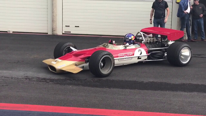

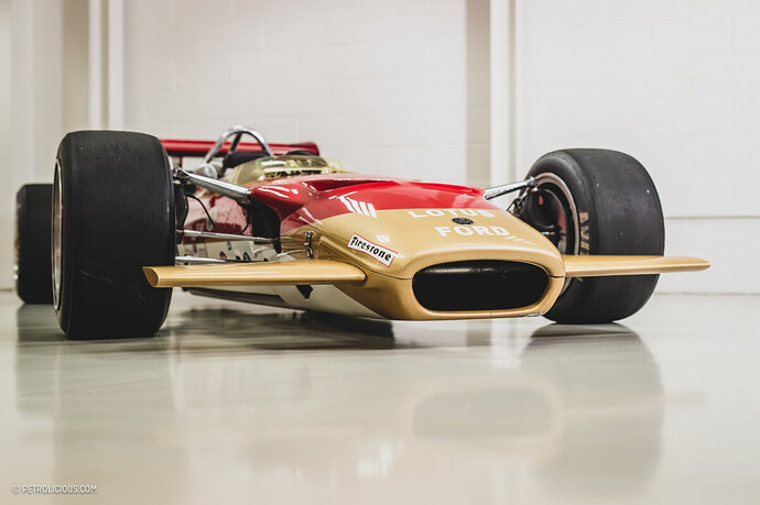

So to cut a long story short, a while ago now i saw Adrian Newey’s original 49b and noticed the nose was very similar in colour to my sample… only problem was no one there knew what the colour they used was and I keep getting told Talbot Aztec by people close to the car. Also, I’ve seen a couple of Classic Lotus cars that have been rebuilt and they have clearly been painted the Talbot colour.

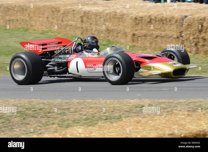

There is a problem with Classic Lotus too, i went to Goodwood and saw a couple of their restored F1 cars and they had used the Talbot colour.
as opposed to (not the best picture, the lights make it look redder than it is in the flesh but you get the idea)

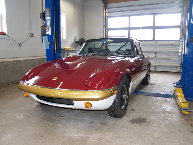

I just had my Sprint repainted this past winter. Here is a photo. If you like the color, I think I can get the formula.
Grizzly,
The color on the bumpers was done by a computer match to the original on the bumper. They had been painted black in 1975 (Don’t ask me why. I can’t recall my thinking then.), so the original was covered. Of course, that was 49 years after the original paint had been applied! It is a very nice match to the new side stripes that were applied. I bought those from SJ Sportscars in the UK.

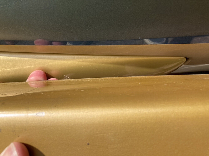

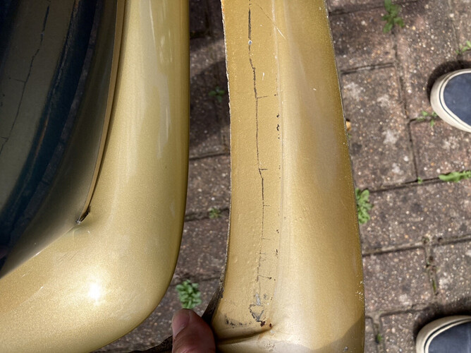

Grizzly, I had forgotten, BUT I have my original - now warped - rear bumper that has never been repainted.
However I would need advice as to how to get an accurate sample to you, as I’m in Kent.

Here we are then, hope they are of some help. The bumper that’s currently on the car was painted 10 years ago, for reference. All photos taken with my iPhone.
The original bumper does look like it’s faded from when it was originally on the car. I’ve tried to include the areas that were not visible once it’s attached. The middle part was dark from all the years of exhaust staining, so I’ve ignored that really.
I’ve tried to hold them alongside each other to allow for lighting differences. The shapes involved makes it difficult to see the same part of the bumper in the same light at the same time.
Hope they help.
Richard
Perfect, Thanks again.
It’s an odd colour, it seems to have a real dark cast to it… it some lights it looks a sand colour and in others, it’s almost brown.
