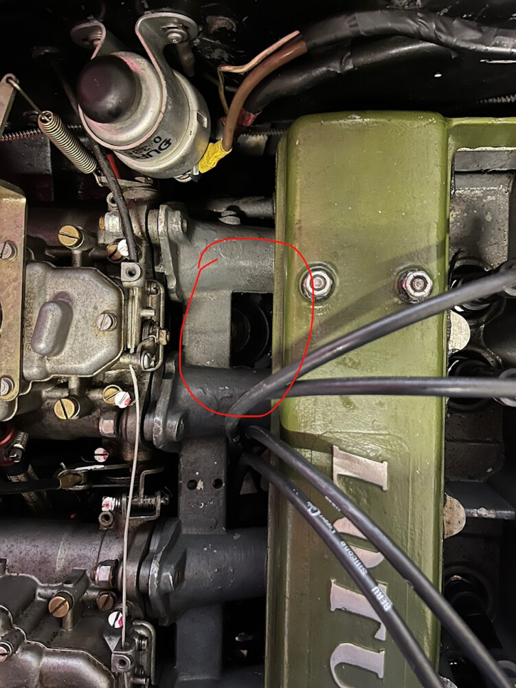

As Max kindly advised, It IS possible to replace the pump from below working alone. Neither the carbs nor the air box need to come off. The oil filter and starter motor DO need to come off though.
Access is VERY tight, even by Elan standards. My car doesn’t have the footwell hole, which would have helped for sure. You need to improvise with sockets and think laterally to find a way to get the two bolts in. And stubby spanners are needed to connect the fuel lines. Dizzy cap needs to come off so you can thread your right arm in.

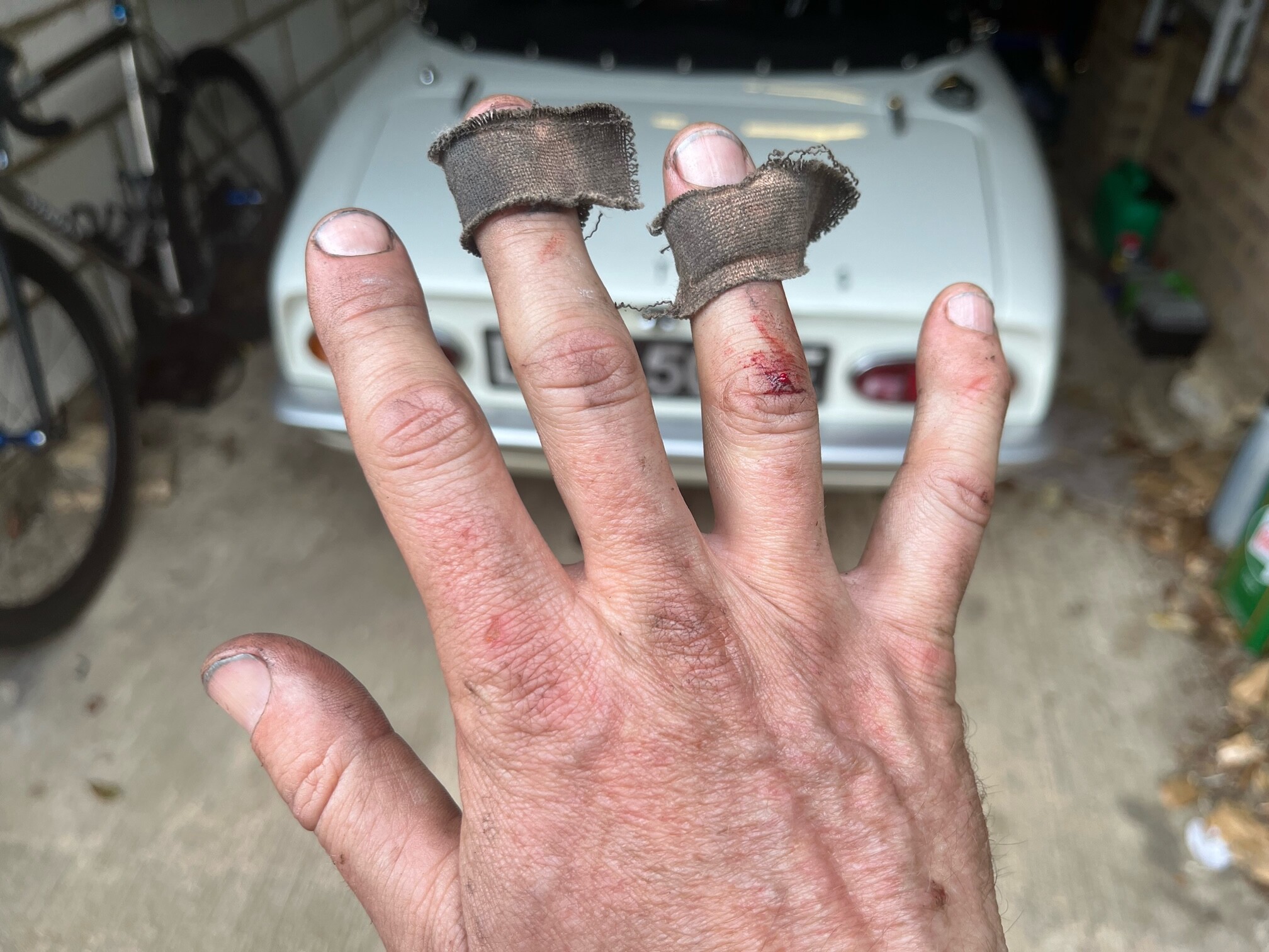

It took me 7 hours to do the whole change out, but but now I know the above it could be done in a couple of hours. Very satisfying in the end but my poor “office hands” took a beating :smiley: . Lots of feeling in the dark and sharp chassis edges to contend with.

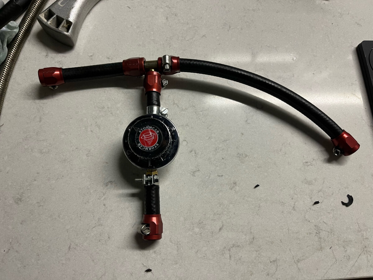

The saga continues. Turns out the new fuel pump I fitted is over pressure (I should have rebuilt the old one). Anyway this is overcoming the float bowls in the Webers and they are running super rich and the car stutters on acceleration no matter what timing advance we set. Called master tuner Tom Airey and he says 1/3 of all the cars that come in have too much fuel pressure and need a pressure reducer fitting, and it needs to go downstream of the pump (tricky with mechanical pump as you know - no space).
Tom recommended the Malpessi type but they need to go horizontal and that would require a bracket on the rad or the carb and no time to sort that out. So I ordered a cheap little one from Amazon and it was delivered same day with Prime (amazing!).
A mate donated some hose and I made up a new assembly, complete with pressure reducer.
Now to fit that and - hopefully - all will be well and Goodwood track day day after tomorrow is a go.

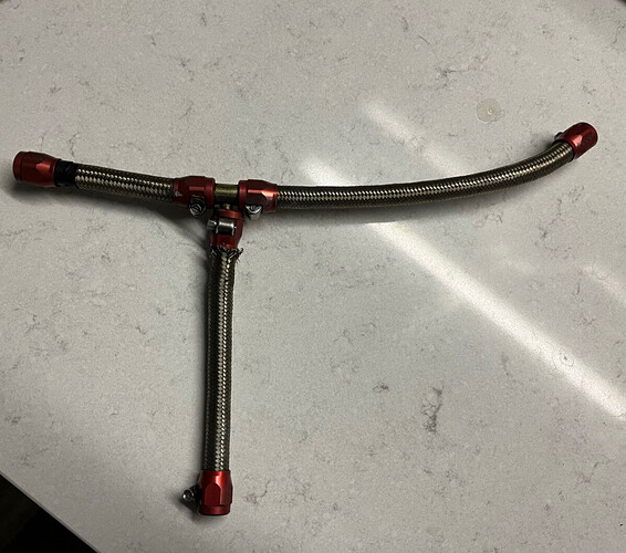

Added bonus - the old hose inside the braids was deteriorating so new hose was needed anyway. When I have more time I’ll get some new braided E10 hose and fit a Malpessi somewhere nice.

Noted that your fuel pipes were cracking up. I fitted braided hoses (from appearences the same type) thinking they would be high quality and a bit of extra protection in the case of a fire. But apparently the deterioration meant that quite a lot of my fuel ended up on the floor of Chris Foulds workshop when he was working on the car! Now replaced with standard - non braided- fuel hose. If it doesn’t last any longer at least it can be inspected.
