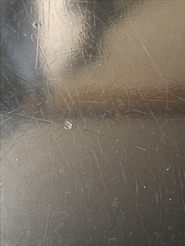

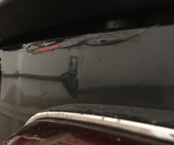

vxah - see the pics below. It could be be poor paint, crazing or dried out paint - I?m don?t know. Lots of cracking in the paint. There are also sections where the paint is bubbling and chipping off to reveal the original red underneath. Would like to hear folks opinion as to whether this is a paint issue or underlying gelcoat problem.
the last photo shows a crack that most likely extends through the gel coat, while the middle photo does not (more of an preparation issue, e.g. lack of proper sealing/primer on a repair where the gelcoat had been sanded down maybe?)

The safest and most durable way to go in many cases would be to sand all the paint layers down to the original gelcoat, which would enable to better assess all defects, but due to the duration of the task one needs to make sure to be able to store the car in the dry for the duration of the work - and that is likely to last more than the worst case initial scenario called for…
The second photo is an example of how the paint looks on most of the top sections car. I don?t think it?s a repair section. I think the car spent some significant time sitting in the sun.
obviously the car has been repainted at some point, at least once. Whether there were some damage to fix and their extent is to be assessed by close scrutiny of the body, inside out (not always easy to photograph).

As for gelcoat cracks (stress induced like the one near the boot hinges), the issue is not only that the gelcoat no longer protects the fiberglass body (esp. against capillary water absorption) but also that the crack extends into it and weakens it : if not repaired to the proper extent in width and depth, the crak will come back rather quickly. It may be a good idea to reinforce the stressed area - but this must be done in a way that does not just push the stress somewhere else where a new crack will develop… the flexible nature of the body must be maintained for a durable repair (feathering the patches etc).

My read of your photos is that you have multiple layers of paint and they have interacted with each other. Get some sandpaper and take a small area off and you’ll have a conclusive answer, but outside of physical damage I doubt you have a gelcoat problem. There is a lot of talk about pinhole bubbles in gelcoat, but I don’t know they are all that common. They aren’t in my experience, but it’s limited with Loti, much deeper with small boats.
The couple of recommendations I would make are : Stick with strand mat and polyester. I say this because epoxy is stronger and it’s a bear to feather. As a beginner, polyester is still plenty hard. It’s already been said that the basic repair wants to be dry and dense, a wet coat is the last step after building. Think of polyester as cement and strand as re-bar. They are good equivalents; like cement without something to give it strength in tension, polyester is just thin, brittle plastic. Especially after 50 years. :wink:
Most paint problems boil down to adhesion. The upper layers in your photos have failed to adhere to the lower ones. There’s a bit of evidence of chemical interaction as well. With fiberglass shells, it’s always best to go down to the gelcoat – you’re going to get an inferior quality paint job any other way because paint just doesn’t adhere as well to polyester as to metal. Sometimes, as with my Europa, a respray will look quite pretty for awhile. Shrinkage, particularly in direct sunlight, accelerates deterioration.

Second photo is caused where gel coat has been removed and surface not properly prepped after.
