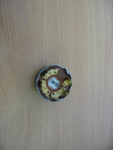

Ah, that’s interesting. Was it the electrical part of the swicth that was the problem? Like this part?
I suspect the ignition switch also. The same thing happened to me, on a bridge in heavy traffic, but it started again with a wiggle of the key before much speed was lost. Yes to that part.

When I pulled it apart it was very dirty and worn looking.

Tim, yes the electical part at the rear of the switch, if i remember correctly there is a tiny grub screw on the side which holds it in

Can the electrical bit be bought separately or is just a case of remove and clean up?
