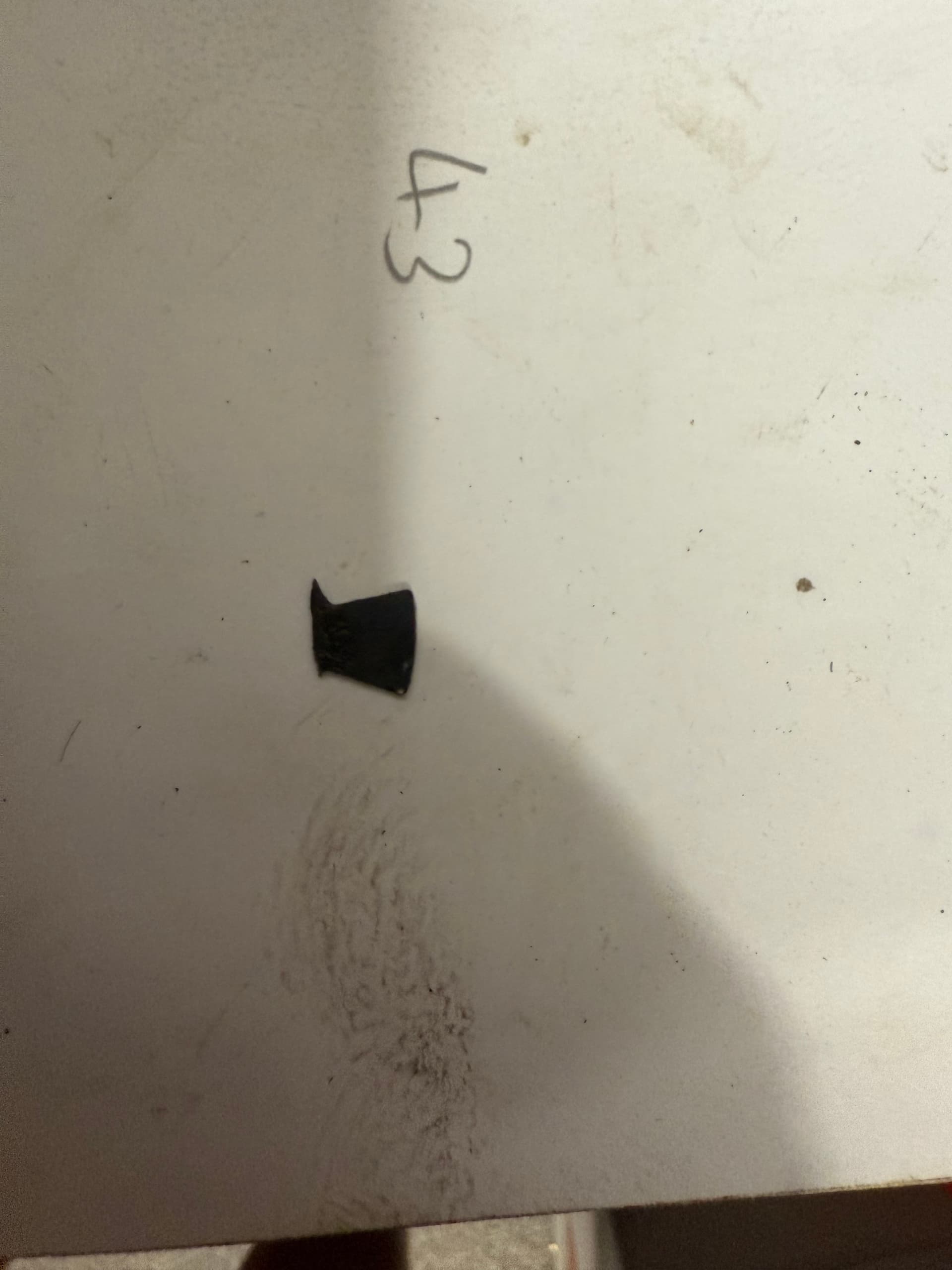

Yes my carb linkage had moved, however found culprit on bad misfire, pot 3 dead, changed ht lead no difference, cleaned all distributor points and rotor and spotted chopper blade no.3 happily resting on distributor. Can some please tell me what type of distributor i should have so i can order the correct part. I’m running Lumenition PMA50 ignition. 'thank you
I think you have a Lucas distributor.
There is something on eBay right now that might fit.
LUMENITION FK 109
