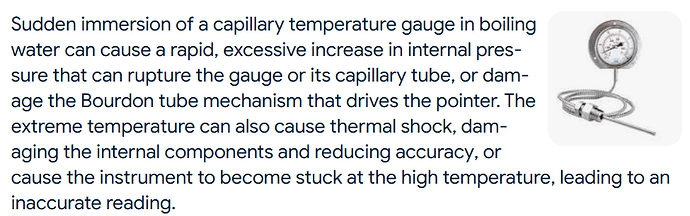

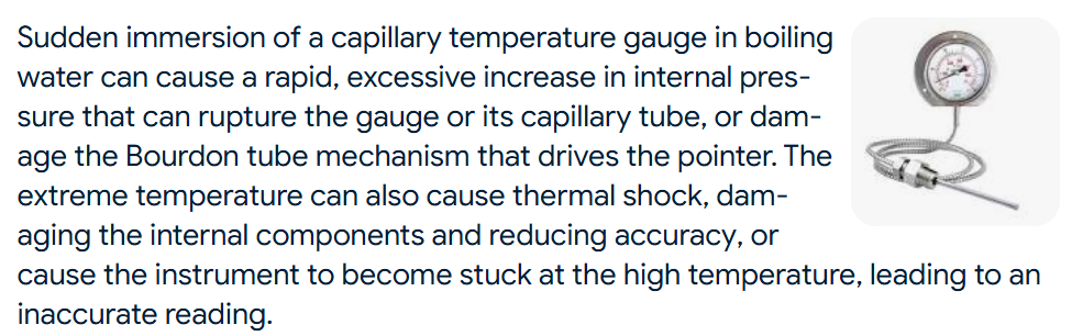

Not a good idea to plunge it into boiling water, you may well have damaged the gauge.
My refurbished gauge came with label warning against doing that and an A I search comes up with an explanation.
Horse/stable door etc. But, thanks for that info anyway, oldelanman.
