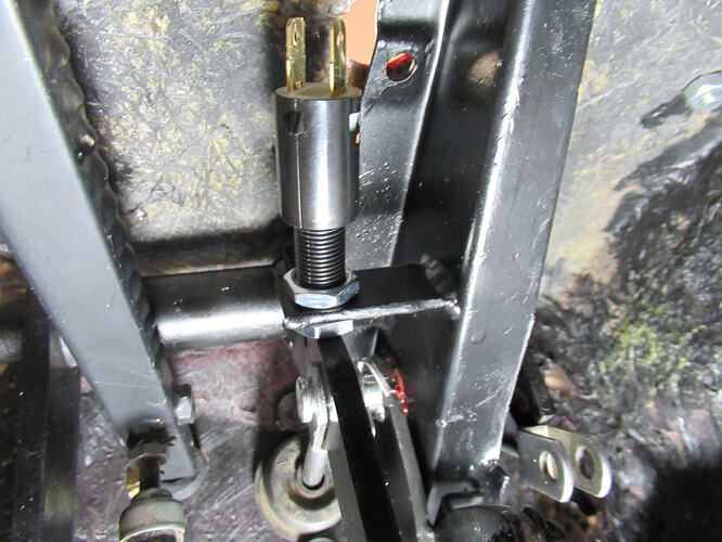

I found a great replacement switch for the brake pedal on my 1970 Elan S4. Olivia&Oliver Brake Light Switch Stop Light Switch Replacement for Chevrolet : Amazon.co.uk: Automotive
I replaced the hydraulic switch on my S3 with one of these. It was fairly easy to fab a bracket to make it work.
I found a great replacement switch for S4 and later Elans. It threads nicely into the original bracket with lock nuts on both sides. It is adjustable and works the treat.:grinning_face: Amazon.com: Olivia & Oliver Brake Light Switch Stop Light Switch Replacement for Chevrolet : Automotive
