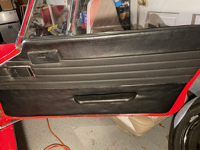

Hello fellow Lotusians,
Today’s update includes new improved door card effort. ( the final result is above)
The fun part about this restoration is that you can switch between technical troubleshooting one day and “arts and crafts” the following day. I like the variety-always interesting. And sometimes the arts and crafts is very therapeutic, instead of mechanical or electrical work each day.
In any case, my door cards had disintegrated. The backboards were trashed. The lower “carpeted portion” of the card was beyond help. However, the original upper vinyl section was salvageable. I always liked that part of the door panel since it meshes nicely with the console. (Didn’t love the shag carpeting used on the lower half much anyway.)
I purchased heavy cardboard stock from an aftermarket performance car place for 15 bucks. Cut the panels as best as I could and fitted the metal door cap to the card. The vinyl was attached using contact adhesive and clamps. My wife is working to stitch some comparable black vinyl together which I plan to glue to the lower half of the cards. I will probably investigate another method to attach the cards to the door and may avoid the original clip method altogether. Another update will follow. Stay safe and be well.
Cheers everyone,
1 « J'aime »
