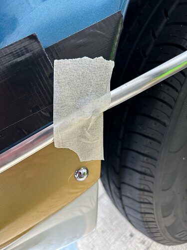

Step 8: Given there was already some clean holes to accept replacement rivets, and I was sceptical about how cleanly I could get the masking tape off once body filler had been applied I decided to take the path of least resistance and re rivet it. So bumper back off (Wheels off and on…) but leaving the strip attached via masking tape.
(Pic 11)
(Pic 12)
This worked better than expected !
Step 9: Time to reattach the bumper and re screw the sides in. (Wheels off and on…) Now the strip was in place I realised why the central bumper bolt was original only 1 or 2 threads in. The central bobbin was not being presented at a vertical angle when the bumper was offered back up. This meant the bumper was a little too low, by 2 mm or so. It was probably only about 5 to 10 degrees off, but it meant the bolt was trying to cross thread into the bobbin. It took many, many tries with side bolts in / out, etc before it finally aligned and I could screw the bolt home. Bumper resting on shoulder, being pushed up against the body and strip, with hands working blindly behind the grill. Almost a classic Lotus position. Anyway it was in ! And I could finally, finally, finish with side bolts. Or so I thought. No interim pictures at this stage.
Step 10: Side screws. Marked based on the original screw location. Simple to drill a pilot hole and then a 3mm drill for the hole into the strip. Note I had practiced drilling holes into the old strip to check it wasn’t likely to shatter. Drill just underneath the horizontal blade portion of the strip. It was at this point that I noticed the rear of the bumper on the passenger side was not as far back as it had previously been and needed some adjustment. Off with the wheel, undo the side bolt…
(Pic 13)

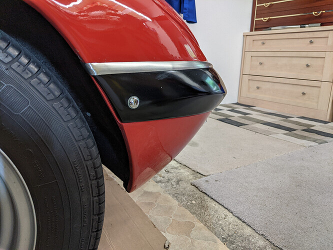

I’m also aware that there are other techniques or ideas that people use, all I can say is that this is what worked for me. Here’s some finished article pictures:

As you say there are several ways to approach this job - here’s an alternative way to finish the ends…
