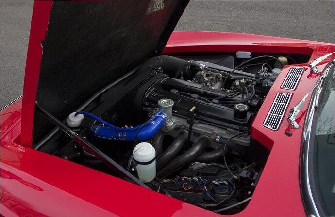

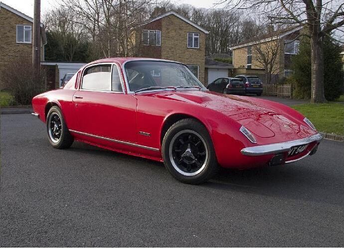

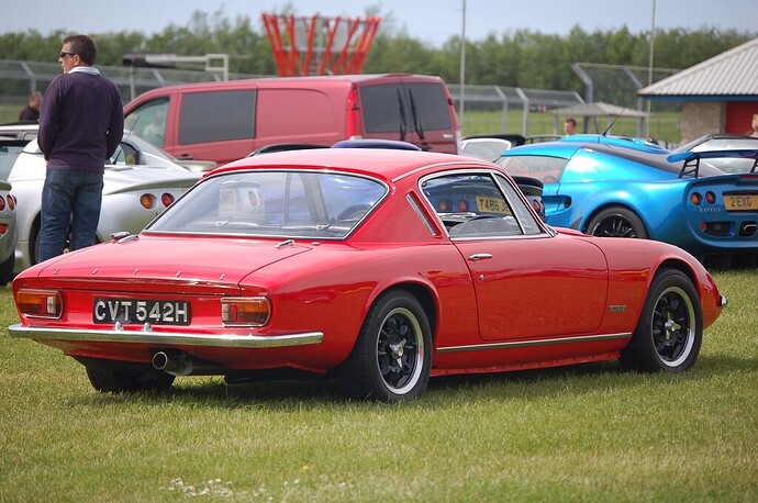

I have spent the last few years perfecting the installation of a 2L Zetec into a standard Lotus galvanised chassis with the aim of keeping as much as original as possible. The drive train has been strengthened in the right places, output shafts, TTR Drive Shafts, lightened Flywheel and proper heavey duty clutch and Track Suspension etc. The Zetec engine bolts straight to the existing Gearbox and fits very well into the enine bay. The original 40 carbs are used and engine runs from special ECU, cooled by big rad and biggest fan possible, never comes close to getting too hot. Engine in standard specification, 155 - 160BHP.
The car performs very well indeed, acceleration is easily 6 seconds to 60, that car has done track days etc and handling is very good. Body fully repainted, interia first class and standard, also fitted new Minilite black and machined aluminum wheels with Yoko tyres. The car is fully sorted, reliable and in A1 condition.
I would like your comments regarding the cars value, where are we compared to a standard A1 +2 and a Spyder conversion ? any comments will be greatfully received.
The car’s value, in my opinion, depends on where on earth you are. Is it RHD? It sounds like an exciting ride. I’d guess it’s worth about what an original +2 in comparable (excellent) condition is worth, unless you’re lucky enough to find a buyer willing to pay more for the added performance.

There have been many questions posed in the past about fitting a Zetec into a standard Lotus Frame.
Your experience will be appreciated by many.
You’ve made a nice job of your project & I’m happy for you that the Car’s running well.
What capacity Zetec did you use? I assume 1,8 Liter.

Hi Eric and John,
Thank you both for your reply’s,
Eric, the car is right hand drive and I am situated in the UK.
John,
It is good to hear from you, I have used a totally rebuilt standard specification 2.0L Zetec with the aim of keeping BHP to a sensible level, compared to driving the car with the original Lotus engine the transplant has transformed the performance of the car, it starts everytime hot or cold and does not have that puff of smoke on start up or any oil leaks, for me it has been a good project and a strong reliable car has evolved still being 80% original Lotus. You are correct it was me that came and saw your wonderful Zetec S4, for me it was your car that kicked this project off for.
Richard

Did you get the 40 DCOE Jetting information from Paul Dunnel or did you sort it yourself?
You share the same starting etc. experience as me; a thoroughly reliable Engine.
I have found that a Spark Plug change every 3 or 4 years is a good thing to do when running on Carbs rather than the originally intended Injection. That keeps the cold starting performance up to scratch.
Is the Oil Filter easily accessible in the Lotus Frame?
How did you manage the half Moon cut out, for the torsional vibration damper, in the vacuum Tank in a used (Petrol contaminated) Frame?

The oil Filter is very easy to reach from underneath the car, regarding the half moon cut out in the front chassis member required to clear the front pulley of the engine, this was done carefully in a car body shop when the car and engine bay was repainted, great care was taken but no fuel contamination found.

Do your Dellorto’s give you any balancing problems and how does your ECU control things? Is it the 4 speed box you have fitted, is motorway cruising more relaxed that an LTC or just as fun & frantic?

Yes the oil filter is very small, the carbs have been okay with the engine starting easily and running very smoothly without flat spots etc, although a final set up on a rolling road is soon planned. The ECU is a Raceline unit with Throttle Pot, I don’t pretend to know how it works but it has done since the first start up. The Gearbox is a rebuilt orginal 4 speed unit, it is reving on the motorway but has great ratio’s for the A roads and fun driving.

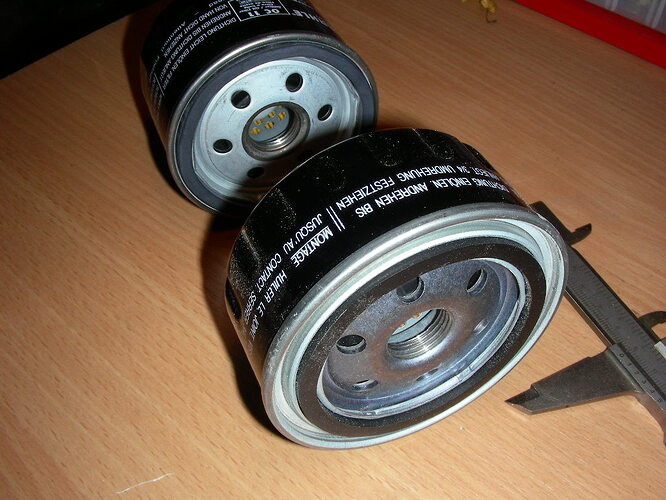

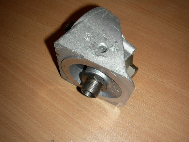

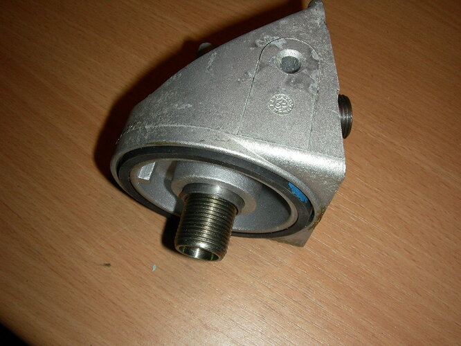

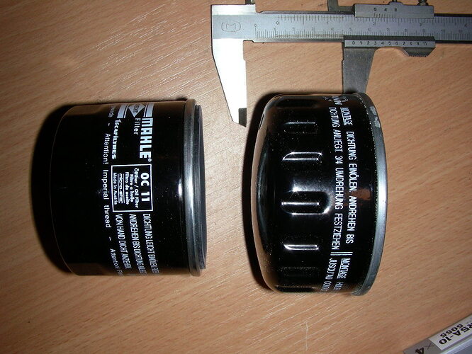

Hi,
I’ve attached a few Photos of alternative spin on Oil Filters that fit my Zetec S4 & a 90? Adapter that I have waiting to be tried at the next Oil Change.
The Mahle Filter is numbered OC11 & the larger diameter Mann Filter W85.
The Mann filter makes up for its shortness with its Diameter (As the Actress said to the Bishop) & it is easier to fit.
With the 90? Adapter it should be possible to fit the original Ford Zetec Filter, which is much longer than he pictured Mahle Filter.
These filters are standardised parts so most other suppliers will have identical ones, just check the Catalogue for equivalents.
I’m not yet certain if there will be sufficient space to fit the 90? Adapter or if I will be able to position (rotate) it nicely so that it will be accessible from above as the Alternator & Carbs close up a lot of the available space.
The Adapter pictured was a gift from Magnetti Marelli but I’m fairly certain that Mahle & MANN have similar parts available in Europe.
By the way, the sealing Ring between the Adapter & Block must be of very high quality material because it should be considered as a “fit for Life” component. The Seals for them are usually supplied in “Viton” whereas the spin on Filters normally have much lower quality NBR seals which get thrown out with every Filter change.
