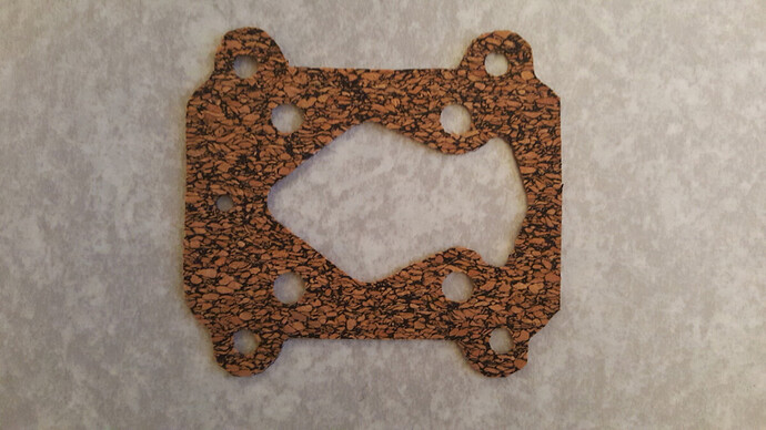

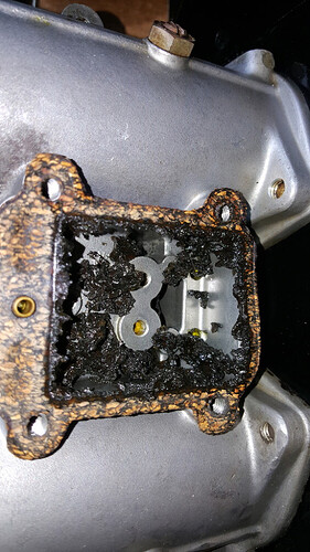

Ethanol fuel (E5) + cork =
what else has been used to bond the cork ?
E5 will continue to be available in the UK in premium grades.
I have never run a twin cam on budget fuel
I don’t know what is used to bind the cork granules in the composite but whatever it is it’s no friend of ethanol either. The granules turned to black mush.
Its whatever the black binding agent is that the ethanol is attacking not the cork itself I believe.

My understanding is that most cork gaskets are bound with nitrile rubber. A quick look at a chemical compatibility chart shows that FKM rubber (Viton)(a DuPont trade name) is comparable with an alcohol/gasoline mixture. Don’t dash out and have a gasket made from this stuff, get a sample and test it first.
