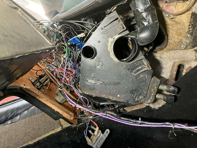

Do I really need to remove the dash to pull the heater box?
The '69 +2 I recently bought has mouse contamination in the heater box. I see that the dash panel needs to be removed in order to pull the box. I have to admit that I’m afraid of disturbing all that wiring. Is it possible to leave it all attached while the dash is gently moved back and out of the way of the box?

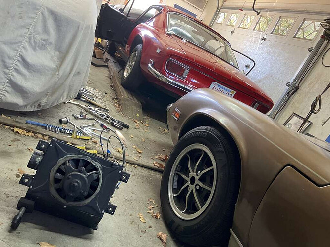

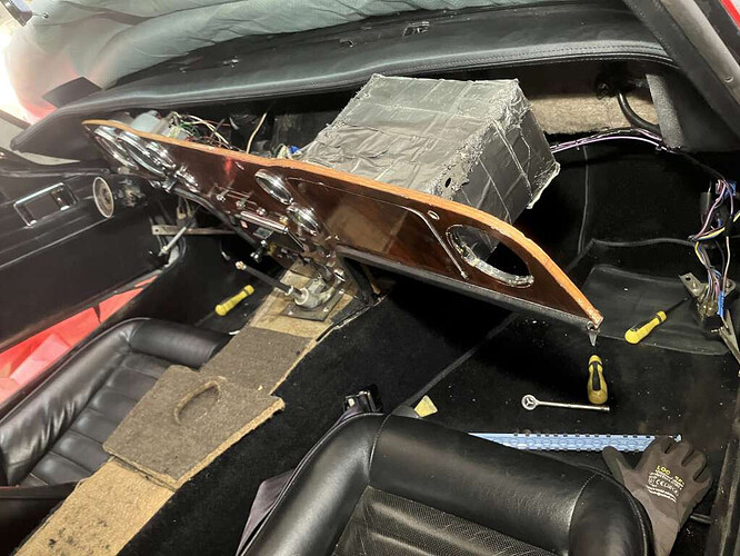

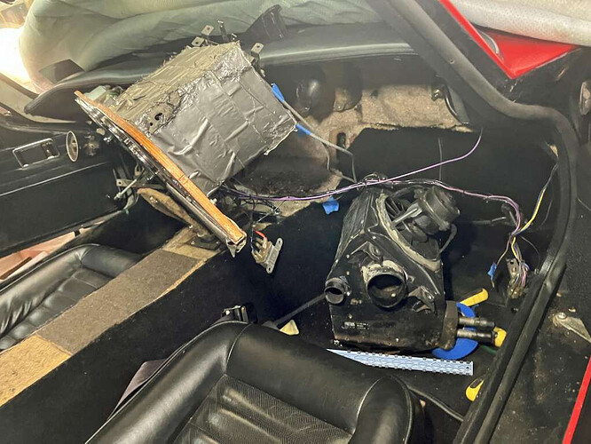

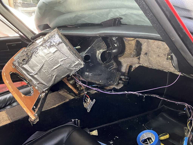

Just to answer my own question for posterity, yes you CAN detach the dash with most of the wiring intact, tip it forward and right, and slide the heater box past it. It wasn’t really all that difficult. I used rubber caps on the heater core pipes so they wouldn’t dump coolant inside the car. I did remove the fiberglass deflector shroud on the bottom first, as I was trying to improve my ability to look inside the box with an inspection camera before committing to remove it. Getting it back in with the shroud attached may be challenging.
