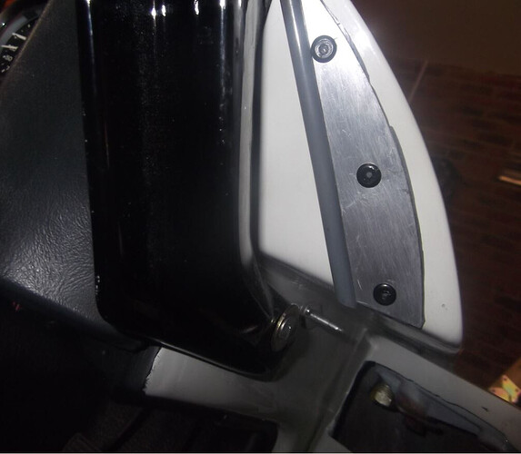

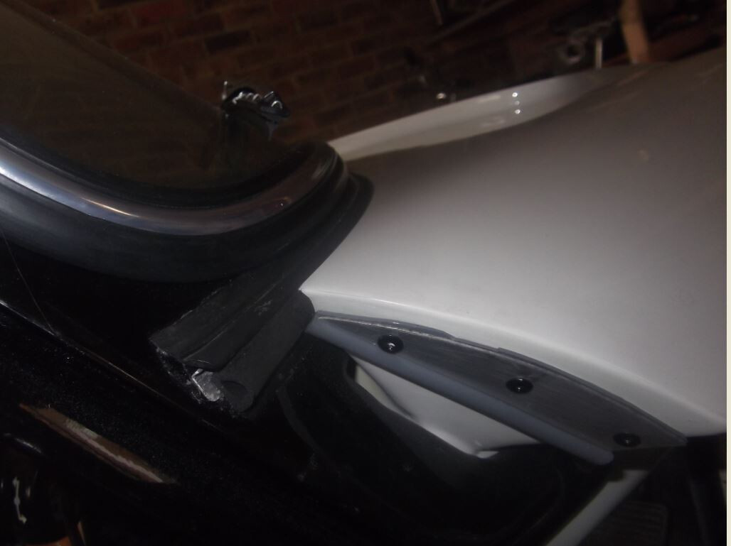

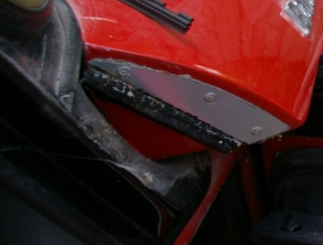

For example my doors show these foam seals. Both not original or effective :mrgreen:
Could you point me out best way to improve this area a other know leaking area on DHC S1/S2?

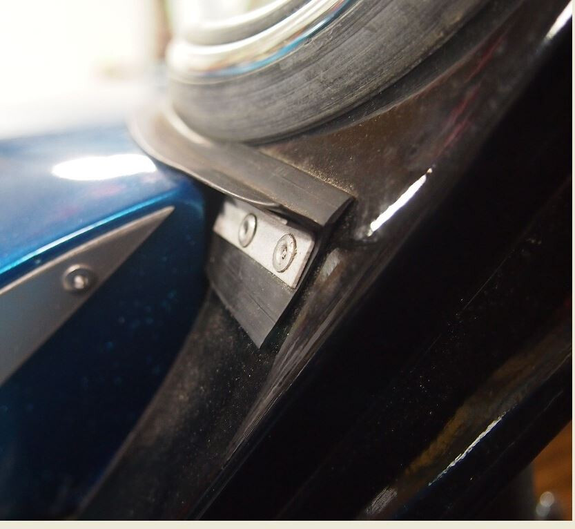

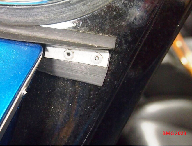

Here are a few pictures of what I believe were the way the seals were originally fitted but I don’t think S1 & S2 cars were ever designed to be water tight :unamused: … Probably the reason why it takes so long to erect the hood and they had rubber mats! :laughing:

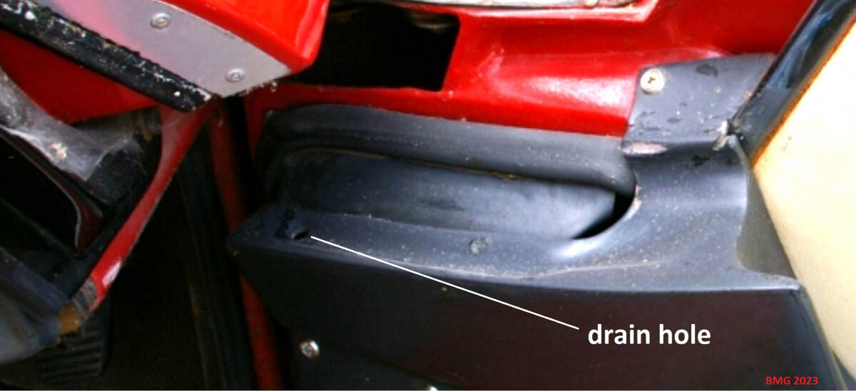

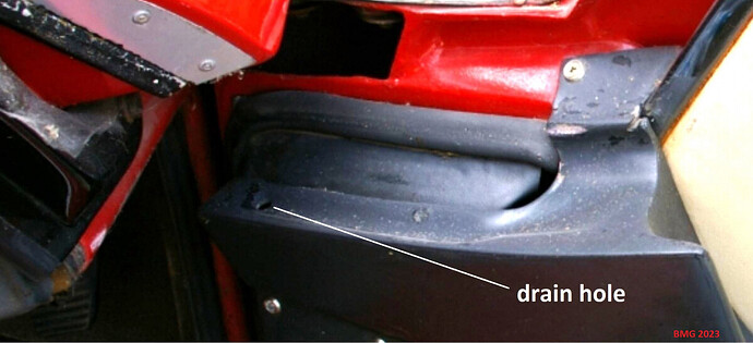

Another point to check is that the fibreglass finishing trim has the drain hole and it is not blocked, it should also have a drain pipe attached inside the door going to the bottom of the door.
