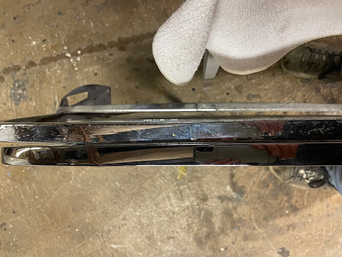

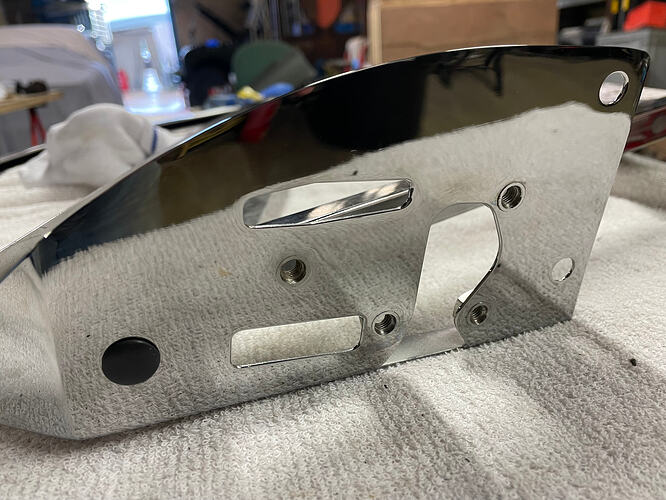

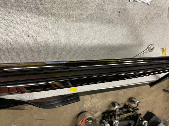

A little earlier than anticipated I have received my window frames back from Nottingham Platers. Wow!
Now I know that all fresh chrome looks good but I am very very impressed. Chrome does not photo well but here goes:
Side by side, an old frame and the rechromed item
Side view showing the lock plate
Hard to see because frames are quite narrow but a great depth to the finish.

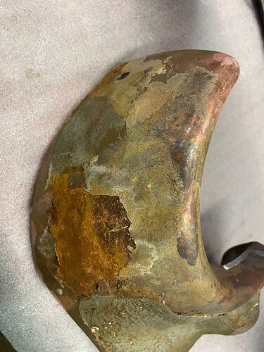

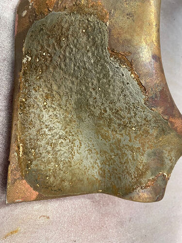

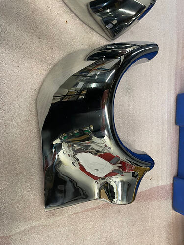

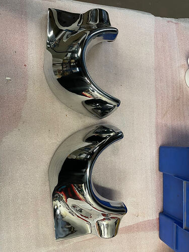

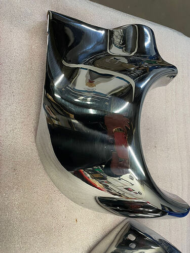

In order to show the quality of their work I have some shots of a Vauxhall Cresta rear end cap, truly dreadful condition. Previous hexavalent platers had tried to layer up the copper to smooth the bumper out, they hardly prepared the metal and the client was not happy and asked Nottingham players have a go, I’ll let the pictures do the talking……..
They tell me that in fact and contrary to a post earlier they me be slightly more expensive than hexavalent platers, that’s because the preparation is more labour intensive (time consuming) to get the results they achieve.
I have no affiliation to them but would not hesitate to recommend them. The other benefit is of course it’s an environmentally friendly process which does away with all the carcinogenic chemicals used in the traditional method. I was able to walk around looking at the various tanks without the need for masks etc.
Not everything can be plated, they don’t do wheels, they don’t do Mezak, (monkey metal) They showed me a Daimler part which had been chemically stripped and looked like a salt shaker, lots of pinholes. They don’t do repairs, dents, kinks etc, their guy retired and they have been unable to find anyone up to the standard required.
