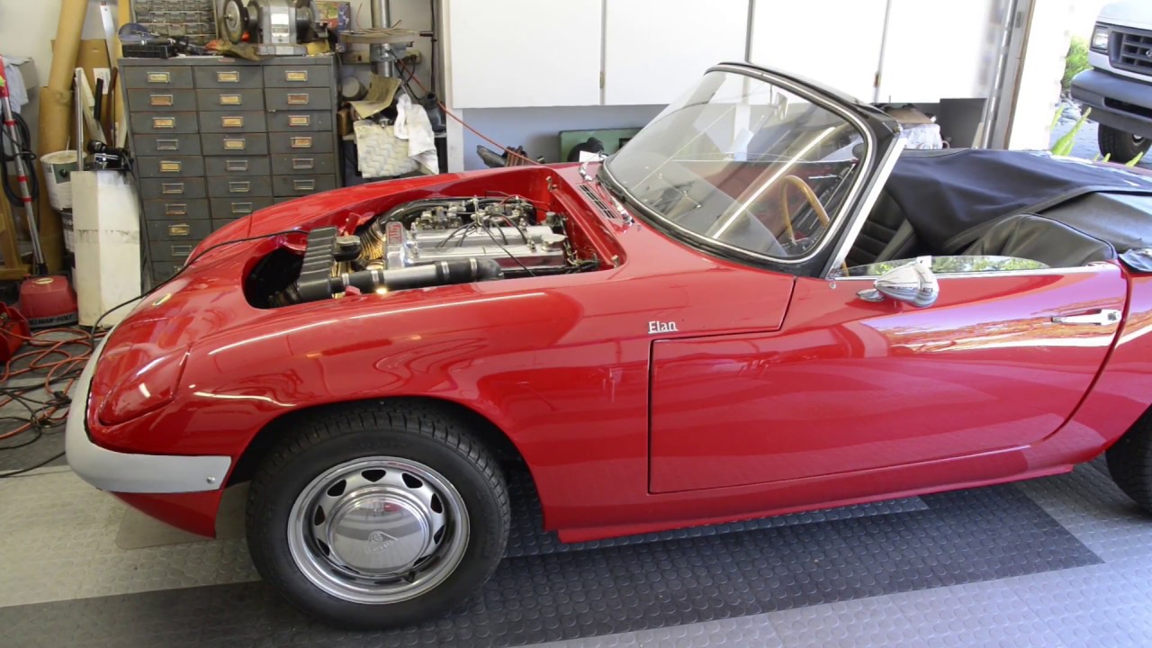

If anyone is interested, here is a video showing my Davis Craig installation.
I installed it because the stock pump developed a small leak. Like you, it is slow to heat up. According to the directions, you can adjust the temperature before the pump comes on, but I haven’t had much luck getting it to work. I’m sure I’m doing something wrong. The good news is I noticed a significant power increase.
