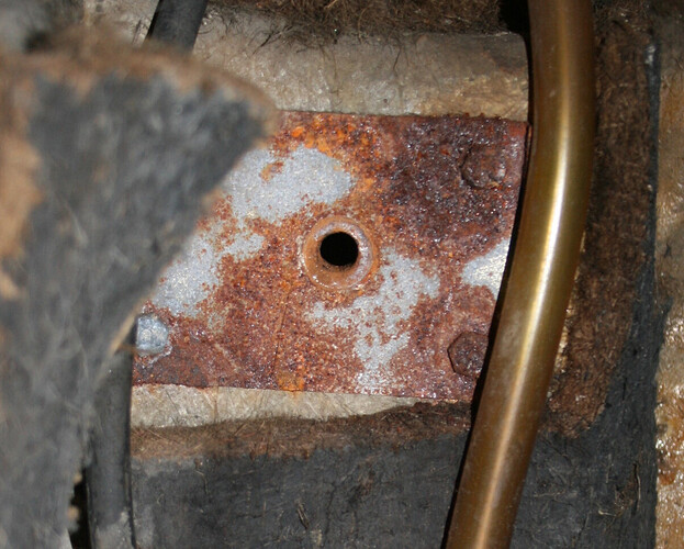

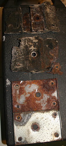

Just removed the seat belt mounts and having inspected the glass fibre i think the whole mount would just pull through the wheel arch in the event of crash. Was crash testing the norm when these cars were built.
Only on an individual car by car basis. :wink:
I think for this reason TTR offers a kevlar reinforced floor to keep the seat in the car. That stuff is significantly harder to get a drill through than fibreglas. John

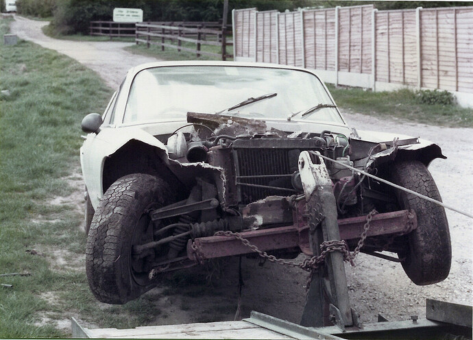

Later on in the Elan cycle, yes, it was. Here are some poor photos from 1970!
Let us not forget that at the time the Elan was introduced, it was considered to have a very stiff chassis and that the fibreglass bodywork was better able to absorb crash shocks than steel. It was therefore considered a safe car by the standards of the day.
Its easy enough to state today that the chassis is not especially strong, that the bodywork is like paper and so on, but we should not judge our nearly 60 year old designed cars by todays standards. Of course, there are things we can now do to our cars to make them stronger and safer, if you are willing to sacrifice originality.
The US DOT was actually impressed with the crash-worthiness @30MPH.
When the cars were returned to Lotus, they were repaired quickly and put in service as test mules. It was the Federal 5mph bumper requirements and the emission controls requirements that killed the Elan and eventually the Europa.

Are those Plus 2 sill mounts seat belt plates? If so they bolt through the inner sill into the steel beam that runs the length of the sill so are actually quite strong - unless your in-sill beam has rotted away. Which most original ones will have by now.

Not the sill mounts they bolt on either side the rear wheel arch.
George,
they should bolt through the fibreglass into the sill member, if they don’t (and your parts do look pretty bad) the sill member has probably disintegrated too and need replacing urgently.
These are the top mounts. PO had sills replaced in 97 they were wax oiled also and look as good as new.

Ah - I see. The top mounts are a pair of plates forming a sandwich with the glass fibre body as the filling. I’m pretty sure that there would have been some sort of standard which would have applied at the time to make the mount strong enogh to resist crash forces. Just had a quick look at my stripped out shell of one of my Plus 2s and the glass fibre around the mount is pretty rigid and thick. I wouldn’t worry about them pulling out in a crash - Lotus did know what they were doing in the 1960s. Nothing to stop you adding a couple of layers of matt or woven cloth between the sandwich plates if you are worried.
