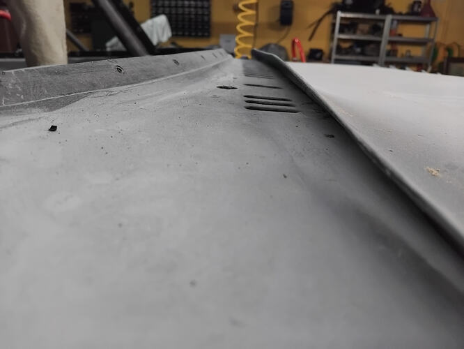

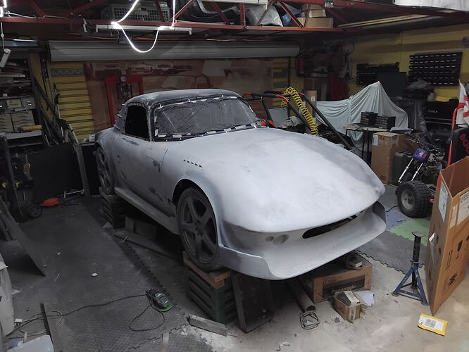

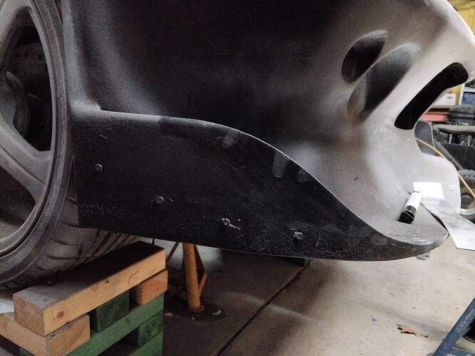

How the Elan looks at the moment, apart from the air curtains that have been reshaped slightly, bolts are for the detatchable dive plane/canard.
Hopefully this will explain what I have done under the car :slight_smile:

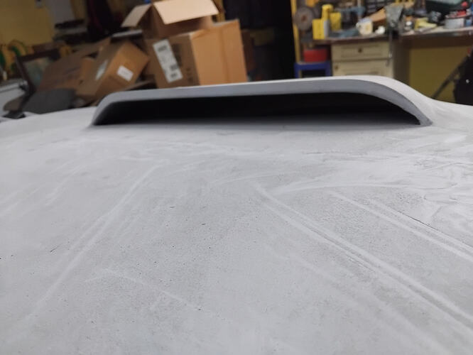

I don’t think your vent on the bonnet is going to be man enough for the job. With the twincam, the engine bay is really tight, I can only guess that yours is tighter. Your engine will be producing much more heat as well. Have a look at the Elise, the hot air outlet from the rad takes up a significant portion of the bonnet area. Your raised lip at the back of the bonnet may work, but as you point out, that is the highest pressure point of the car.
Good luck, and keep the updates coming.
Thanks.
I am now actively looking for a secondhand copy of said book as a new one is a tad expensive :-1: As I am looking for slipperiness and the main downside with downforce is that it creates drag, which presents me with a dichotomy between grip and speed. I am trying to reduce drag as much as possible but improve traction and stability at the top end without the advantages of a windtunnel. Also, there aren’t other racers trying to achieve the same thing on the drag strip with a similar car that I am aware of so I am sort of working in the dark. But it is fun :slight_smile:
The bonnet vent was designed MANY years ago and, if I strated again, it would be different. However, it was designed to extract air from behind the radiator only without detracting too much from the overall shape of the car. Why it is slightly offset, I now can’t remember :slight_smile: The Elise hasn’t got a tall engine to deal with which means packaging is easier IMO. My real problem is the lack of inner wheel aches which makes the airflow in the engine bay chaotic. However, racing is restricted to 1320 feet at a time so cooling isn’t as important as on a roundy roundy car.
The raised lip idea is from my head, so have no idea if it will work, but I think that the theory is sound.

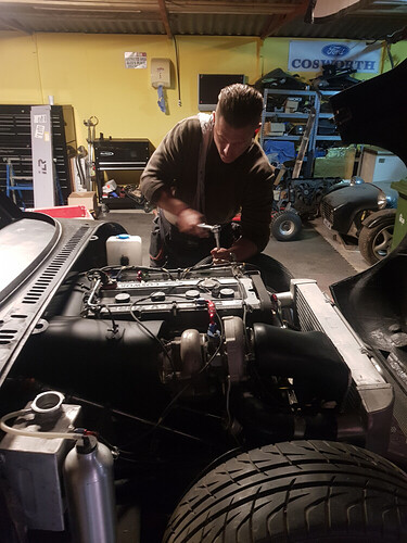

A little clarification of the start up video. It was done at Geoff Page Engineering where my Son, Alex, works. I would not trust anyone else to work on my baby. Geoff built the engine to an agreed spec many years ago and this was the first time it had started up. We weren’t sure whether the hydraulic lifters would work properly after standing for many years. The car was at GPE to have Alex go over it to make sure I hadn’t made any stupid mistakes and to check everything was tight. Once that was done it was time for the first start up. Alex is on start up duty (he is on the right). It didn’t start up first attempt because he had forgotten to turn on the fuel pumps :slight_smile: Once he did that it started pretty quickly once the fuel arrived. Lifters settled down pretty quickly and the valve freed itself, phew!
Although we were running a Life F88 ECU we quickly discovered that it didn’t have the facility to run drive by wire. When I started building the car DBW wasn’t particuarly reliable as an aftermarket mod so we decided to stay with the original setup. However, as the build evolved and I upgraded to a 6 speed sequential and flappy paddles, we went to DBW. As Simon was calibrating the ECU we dicovered that he couldn’t calibrate the throttle! Although we could start the engine and run on idle we couldn’t use the throttle. Not an issue as we also didn’t have a radiator fitted and the intercooler wasn’t installed so the turbo wasn’t operational anyway :slight_smile:
We started with just turning it over to get oil pressure. This went up to 80psi, due to the relief valve sticking. We hoped that it would free itself because the pump is in the sump!
So at least I know that the engine and fuel system works.
