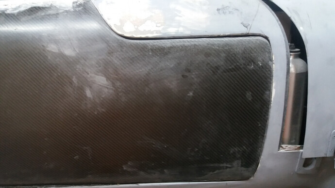

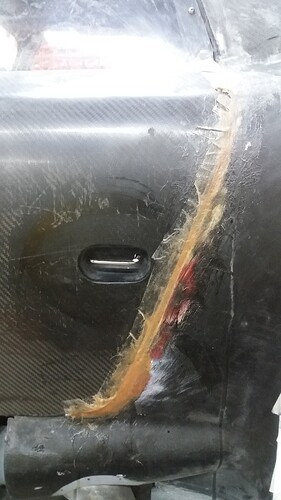

Started to sort out the door gaps. Work in progress.

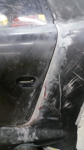

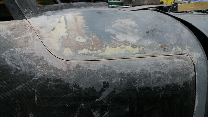

For anyone interested, here is how I am dealing with the door gaps. This may not be the best way of adjusting door gaps but it works for me :slight_smile:

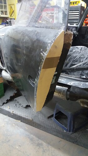

Cardboard for the gap.

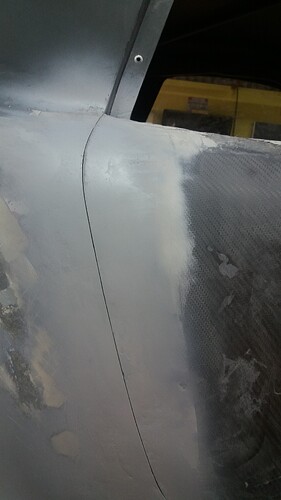

P40 to fill gap.
A little fettling still required bu getting there.

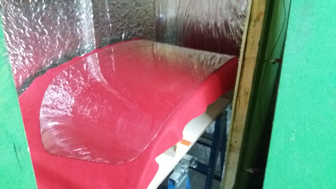

For anyone remotely interested in vehicle weight reduction, I have just compared the Elan’s glass to polycarbonate. Original glass weighed 18kg, add the rubber seals and it tops out at just over 20kg. Allowing for the front and rear fixings the polycarbonate replacements weigh 5kg, so around 15kg saving.

I’m not sure if it’s allowed for App K, haven’t checked. I might do if the car comes in overweight.

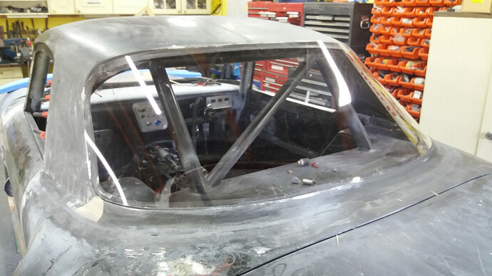

Made the rear screen today. Turned out pretty well, easy this thermoforming malarkey :slight_smile:
