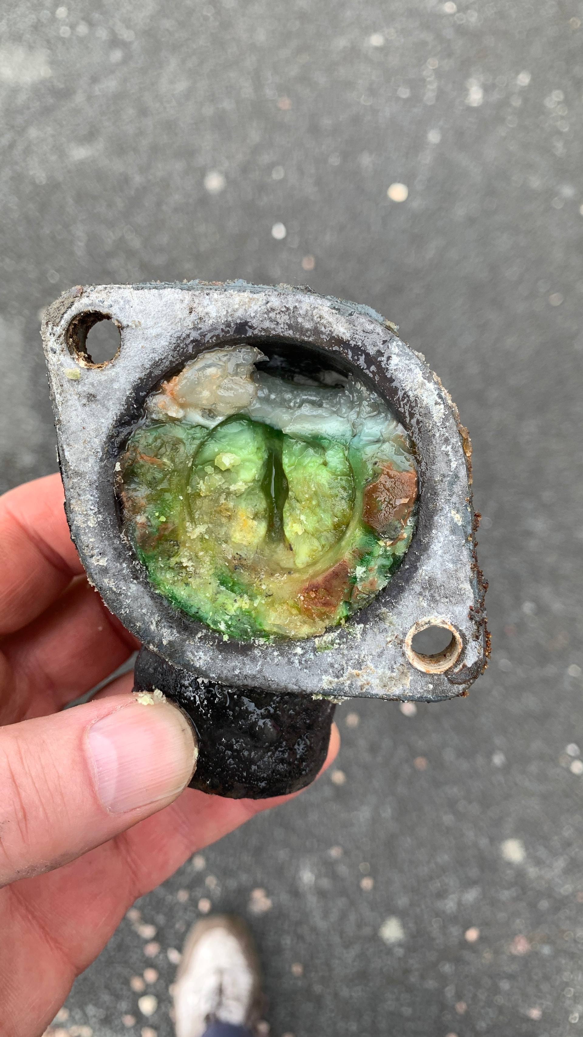

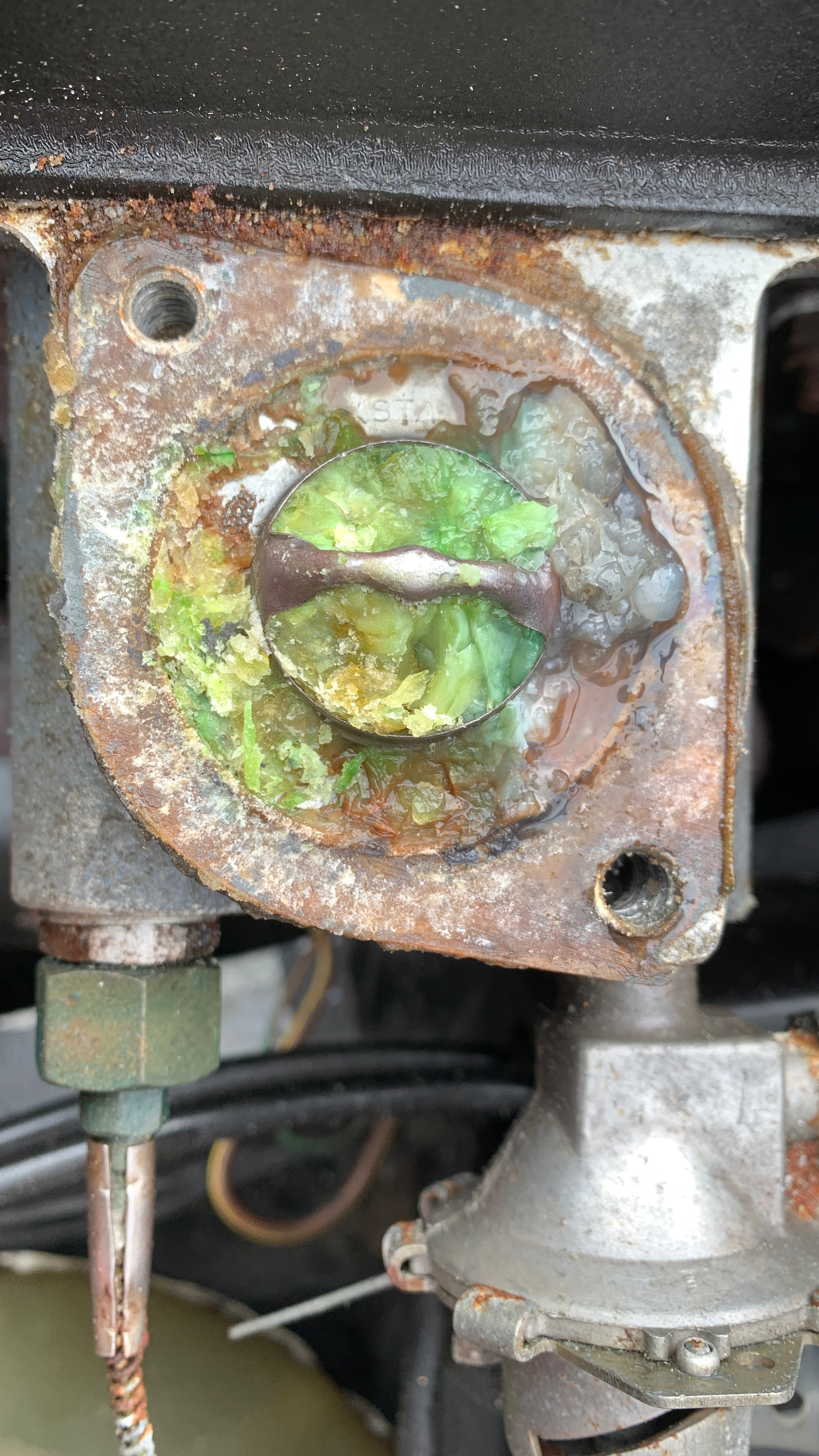

We now come to the cooling system. I realised the thermostat wasn’t opening so ordered a new on (SJ Sportscars, thank you) and duly removed the thermostat housing. OMG, what the hell is all this! I can only guess that the anti-freeze has somehow turned into a waxy solid gel. I have never seen anything like it before, no idea this could happen. But it did… :frowning:
So pls, any help, advice or just general enlightenment as to what has happened and how to sort it.
So far I have removed the radiator, dug out the thermostat, removed the gunk from the stat housing and also the same from the bottom hose inlet to the water pump. My garden hose jammed in the stat housing and sealed up now runs freely out of the bottom of the block.
Worried about any other implications and what to do to mitigate any other possible problems.
Thanks for any advice!

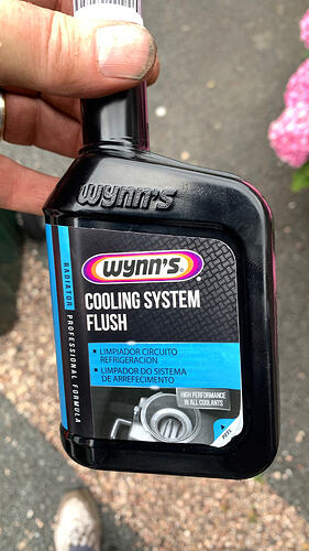

Run the car with water and a flushing additive, flush, then run with water, drain, check , repeat till clean, then add the coolant, I use the old school blue type, which contains no additives at 33% concentration with distilled, not tap water (but you can go up to 50% in vokd climates) and I change every 18 months. Some use the modern IAT antifreeze, which lasts longer, but never mix brands. Do not use a modern OAT antifreeze..
