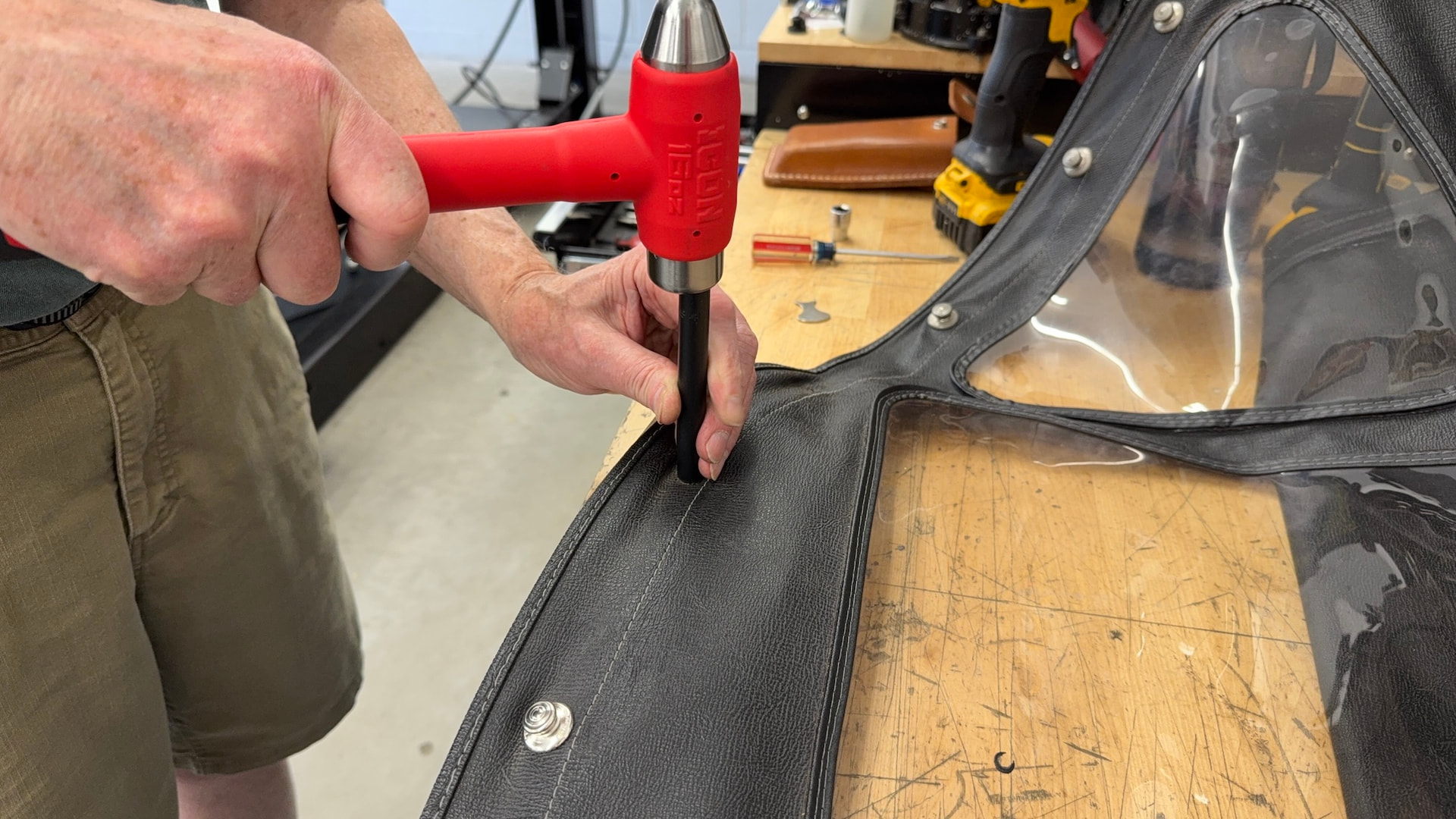

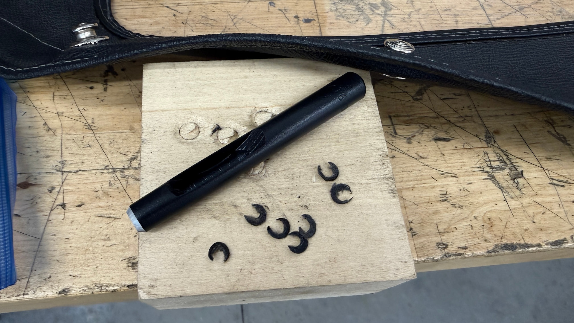

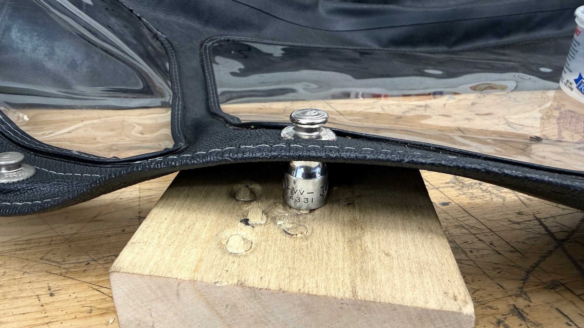

Done and dusted. I used a 5/16” punch and a block of wood under the material. Once the hole was made, a 3/8” socket underneath made it much easier to press the Tenax top half through the hole far enough for the backing plate to catch some threads. All in all a very easy conversion. The tonneau will present a bit more of a challenge as it has no existing holes and so I’ll have to spend time fitting it as I go.
I have an appropriately sized canvas duffel on the way for trunk storage of the liberated top/hood.
