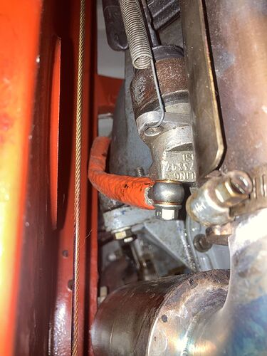

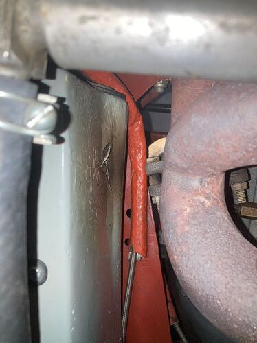

Kurt. Here is a picture from the top looking down at frame rail. The silver on the left is the thermostat extension of the head. I have pulled the line with firesleeve out from under the body. Normally you can’t see it. This picture is over size so I can’ t upload but one. I’ll send another from underneath. The line is routed back to the side of the bellhousing and curves forward to the slave. You’ll see it in the next picture in the next post. I hope it makes sense to you. I have tried to keep it as far away from the exhaust as possible. The exhaust header is the original cast iron manifold. from the manifold back is SS custom made by a friend who makes exotic exhaust system. I traded him some fiberglass repairs on a boat for the system. good for both of us. Gary
Here is a photo from underneath. The exhaust resonator can be seen and the line comes in from the backside of the bellhousing to the banjo fitting. I’ve never had any trouble with it in several years including the trip to LOG in Salt Lake City and that was a hot trip. Just how I did it. I hope it gives you some ideas. The orange fire sleeve is an aircraft product from either Wicks aircraft supply or Aircraft Spruce and Specialty. No affiliation with them. Gary

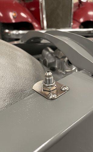

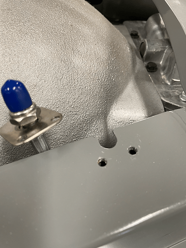

26R chassis. AN3 bulkhead fitting, flex line down to slave cylinder, rigid line up to MC.
