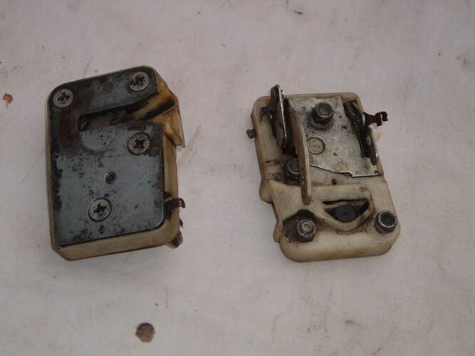

I dont think anyone is entirely clear as to which part you are looking for. I certainly am not. I think you are talking about the white nylon and metal part, about 4 x 3" square, that is fixed to the door skin shut face with 4 countersunk head set screws, is that correct?
And if it is, I believe these are unobtainable.
Leslie
Hi Leslie
You are absolutely correct in your assumption,and yes I understand that they are unobtainable. That said, I’ve still got to solve my problem somehow. Thanks for your comment.

These?
which is which side?
John :wink:
The one on the right is for a left hand door and vice versa. You have some gold dust there JC, just want taking apart and replating.
Leslie
