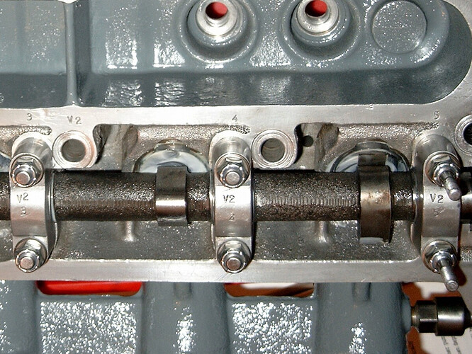

A thought just struck me as I was reviewing pictures of my recent engine rebuild. The engine has always suffered oil leaks from the ‘D’ plugs, which seem to stand proud off the head by a mil or so. I have always accepted this and put it down to being a Lotus. All the cam caps have their number stamped on them, with the matching one stamped on the cylinder head. In addition, their is a ‘V2’ stamp on them all, including the head - see picture. I wonder if the head has had new caps & been line bored at some point in its life? Has anyone else seen this before? It would explain the problem with the 'D’plugs…

I would think that a camshaft linebore would tend to decrease the amount by which the half moon stand proud, no increase… and a good machinist would probably line up to the lowest bearing level in the head and take some material from the foot of the caps so that the new axis after line bore is almost the same with respect to the head.
A top head skim (to take up severe warpage?) would go in the direction you describe - but I rather suspect that half moons not flexible enough (too old?) or not properly seating (center nipple at the bottom) would more likely be the cause of the observed leaking side effect.

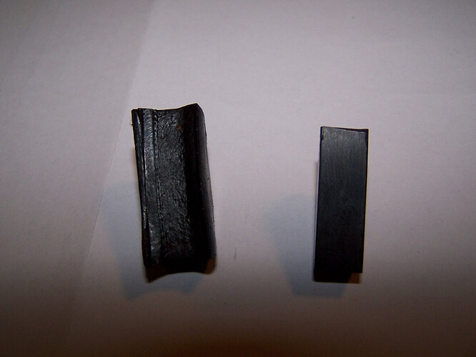

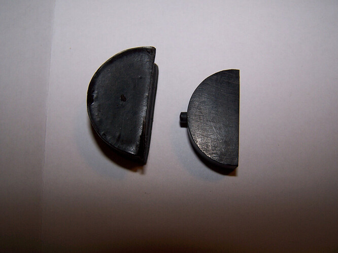

On reflection, you are right… I have used ‘D’ plugs from a variety of sources and they are all pretty hard, apart from one batch that swelled up ridiculously - see pic. Always used the same oil, so that was not the cause. I can’t see them being squished down by the cork gasket, which is where they leak. I do use minimal sealant.

The V2 markings have been added perhaps by an engine builder to keep track of multiples sets of cam bearing caps and heads. The number stampings for the cam caps and on the head look original so it does not appear that the top of the head has been machined.
It is possible Jeremy, that your head was built by the infamous Twin Cam engine builder Von Braun, and he expected the motor to go like a rocket :laughing:

Yes, before my ownership. They were ‘spot faced’ by QED when it had a full refurb by them in 2003. I had no idea what ‘spot facing’ was, when I saw it on the invoice… Doesn’t seem to have got any worse in the intervening time & mileage (100k). Perhaps using a torque wrench helps.
