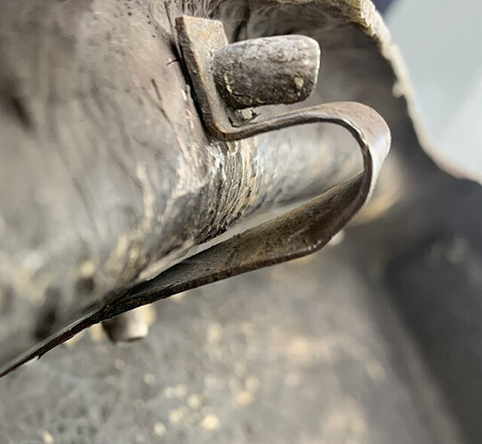

Have you checked the hook on the bonnet is not bent in a downward position, thus relieving the pressure on the spring to pop the bonnet to a reasonable height. My sprint releases to approx 150mm.Take the bonnet off and bend the hook more towards the front of the car.
Good luck

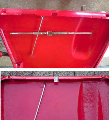

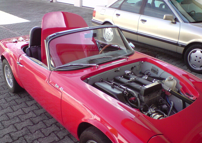

Alternatively, you can modify everything a little.
Not for purists, of course. :laughing:
I can remove my hood in seconds, although I rarely have to do that, not even to check the oil level :smiley:
Urs

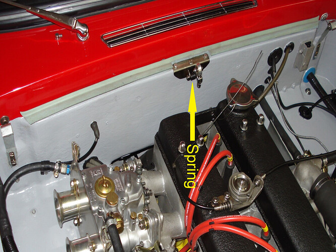

Here is the anchor on mine
Hi
That is a totally different set up to my sprint. Whether it’s an early set up or a bodge up I don’t know. Unfortunately I cannot send pic from my Mac.I could do it on my phone if you send me an email.
G
Hi Mark
Pics sent to your email.Hope they help
